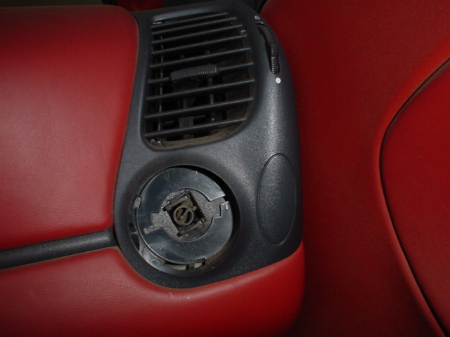

The fan noise is probably the fan for the interior temperature sensor, which is located just below the left hand air vent.

There is a temp sensor fan there. You can see it if you pry off the round grill. On my 1997 Boxster the fan is on when the ignition is on. It makes no difference if the heat or a/c is on or off.
