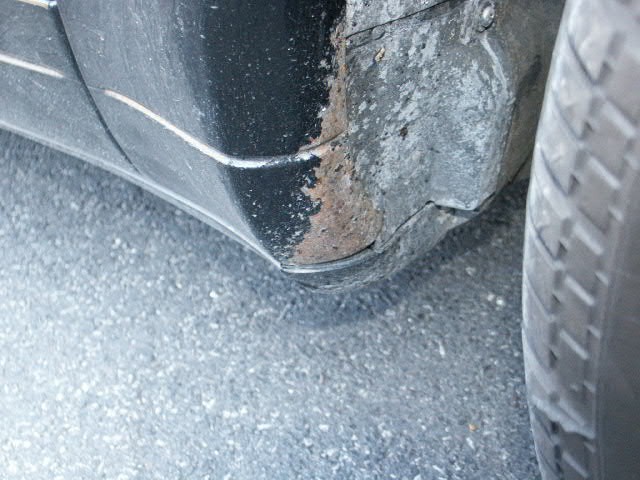

I had a ppi done by a party which currently will remain nameless . I am currently in negotiaitons with them about a spot of rust on the wheel arch about 4 inches by 1 inch average. I was bad to miss it and although the car is black, the check came back with no mention of it. I found it after 2 weeks after the first wash (the 993 that is). A bodyshop has told me that this is a known area of weakness (to him at least)!
Certainly I was happy to pay £200 for PPI's on a couple of cars for peace of mind. In my experience the independents around Surrey are very good. I may name names if the party, who missed the rust, does not compensate me for it to be fixed and we go to Court.

Rust on wheel arches sounds a strange one? any pics, I would be interested to see the problem area.
Sorry to hear about your bad PPI.
Meant to say in my earlier post that I have never heard of rust in the wheel arch for a 993 (fully galvanised body), was an issue with earlier 911's. If there is rust, could be indicitive of previous damage that has been repaired.
I've seen it on the back of the front wheel arch where the body panel turns into the arch and ends. There's a strip of painted metal before the black and I have noticed this edge rusty on some cars I have seen.
Ian.
ian_uk's answer was spot on: on the bottom at back of front wheel arch . Funny enough the well known organisation who did the PPI suggested a strip of rust 4 inches by 1 probably arose after their inspection which was 3 weeks before I found the rust. Seems a good reputation is not worth anything to some of those in North Kent who do PPi's
