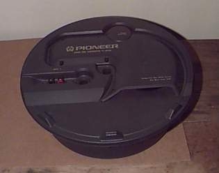

I've got one of these inside the spare wheel, hidden out of the way.
They come up on e-bay now and again. I picked this up for about £20.
Pioneer TS-WX50
