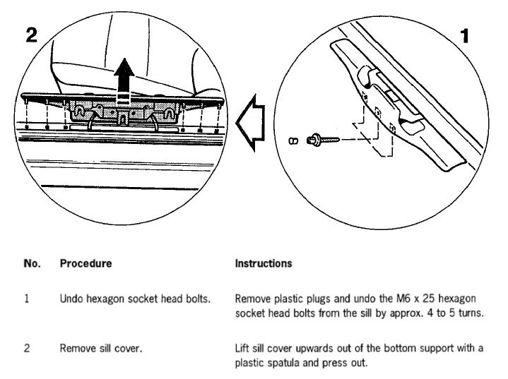

There is a solenoid connected to an arm which locks the levers when the alarm is set. Perhaps it has jammed. I would take the panel off and investigate. On the side of the panel you will see two small rubber bungs. Remove them, which gives access to two allen screws. A 5mm allen key IIRC. Loosen the screws 4-5 turns, and the panel lifts off vertically. It needs a little effort, as there are clips holding it too.
Edit: Diagram added retrospectively to clarify:

I think I'm correct in aying that the panel will come off with the levers locked. It is fairly well fixed by the plastic clips at front and rear, and takes some bravery to prise the panel up at each end.

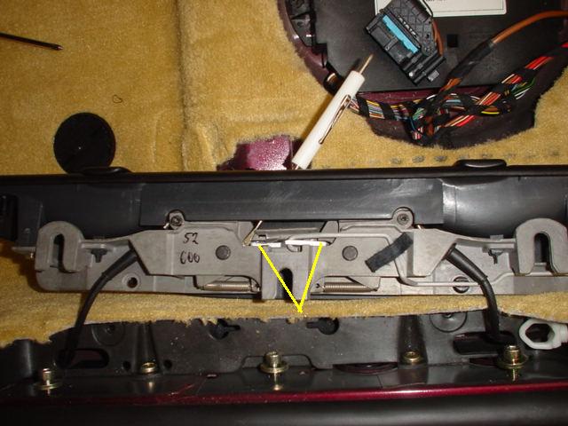

The other thing you can try is to get a small screwdriver in the gap between the levers, and try to release them manually. This photo might help to see what you are aiming for: (LHD car shown).

However, all sorted now, it appears the solenoid was in the locked mode and pushing it back has sorted everything out.
