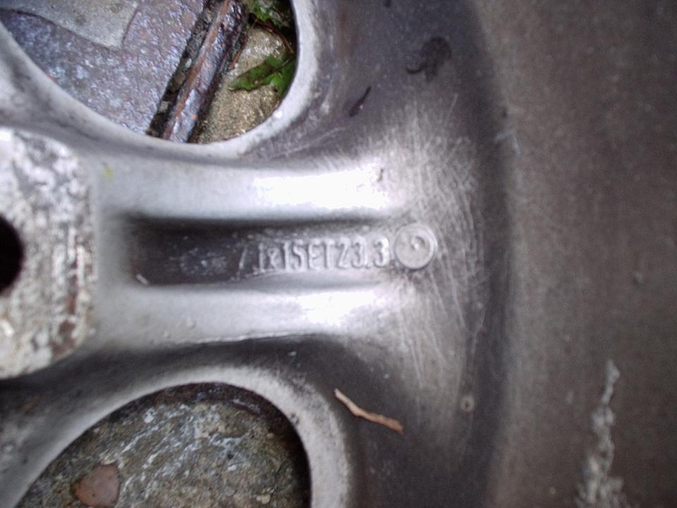

To be certain you'll find the offset cast on the inside of the wheel. They'll be either 23.3 or 53.3. Here's a pic of the inside of one of my old ones to show what you're looking for.
regards, Phil
Both the 911 and the 944 had the 30mm spacers on all round. as phil says the offsets are 23.3 which is for the early cars and the 53.3 is for later models,so if you are fitting late wheels on an earlier car (53 offset) putting 30mm spacers on would make them fit as the correct 23 offset, Try ringing somwhere like jasmine as they sell the spacers and would be able to confirm the right size to get.
