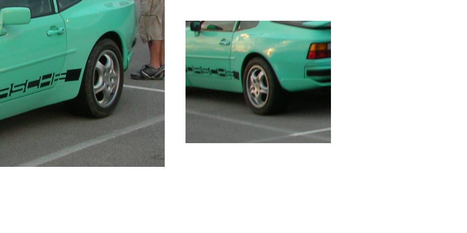

they went on front and back ok without spacers, that said I'll probably put spacers on the back just to pull them out a little to look better in the wheel arches.
With 30mm spacers.
Mike[:'(]
I fitted the above wheels with 16mm spacers and worked a treat, and look right too. I was lucky the spacers came with the deal.
