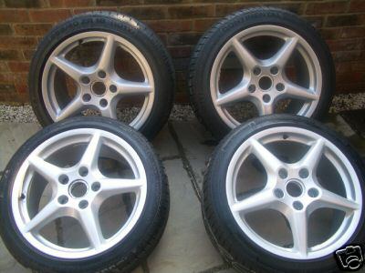

Hi all,
Got the chance to fit some wheels from a MY06 C 2 Cab 997 to my MY99 C4. Current wheels are 18" Turbo IIs with standard 225/40s front and 265/35s at the rear. The new ones are the 18" Penta thin 5 spoke type. Will they fit and will I need to fit spacers? Thanks

Are these the one currently on ebay ?

Yes, they are currently on Ebay. Having read previous threads here and on other forums I think the fronts will retract by 1mm and the rears will move out by 7mm. My 996 has the M030 lowered suspension so I may need to adjust with spacers.
I also think the fronts are likely to be 8J rather than 7.5J so could have a slightly thicker sidewall. Will talk to Jasmine as you suggested.
The picture you posted is a 9x6 series wheel - Carrera. This has thinner spokes than the equivalent wheel on a 997 - just in case you thought they were the same wheel
