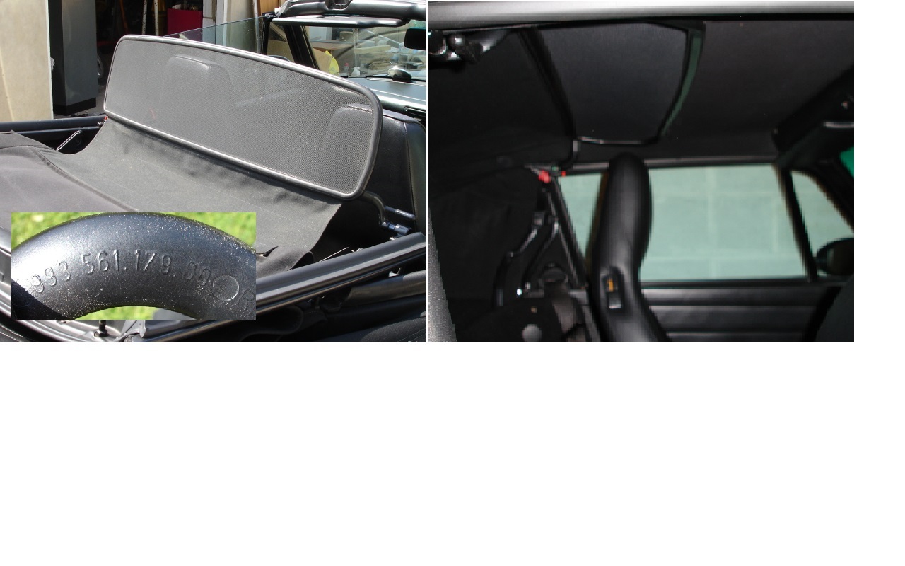

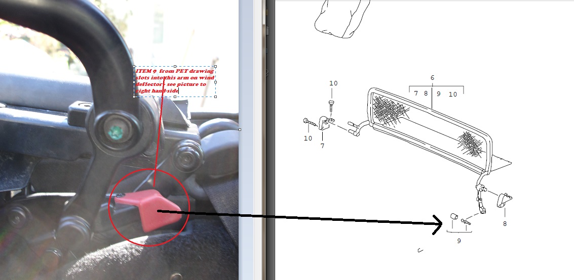

The genuine Porsche wind deflector for the 993 zips into your hoods headlining (if you look at the headlining you will see a zip assembly) The pivot points are slotted into 2 brackets located one on each side of the hood uprights.
When the hood is up - the wind deflector forms part of the headlining and when you put the hood down the wind deflector automatically deploys - please note you cannot have passengers in the back when fitted.
See pic of the exploded parts diagram for the wind deflector - which shows the wind deflector in full. I don't believe you can purchase them from OPC now - however Gert at Carnewal still has them - P93 wind deflector in upgrades section on his website - price 350 US dollars.
Makes a huge difference to driving with the hood down - no more wind buffeting and far quieter also.
I'll try posting a pic of it deployed and stowed - but only allowed one pic per post apparently.
Hope that helps

The 'flappy skirt' is a key part of the set-up, as it closes off the rear seat compartment so ( largely ) stops the wind buffeting in that way ( also helps stop your things on the back seat flying out... ).
The zip ( apologies if I've caused un-due alarm ) is just used when you fit the deflector - so with it raised up or down the zip can stay fitted.
It does fit into the luggage compartment - I think the deflector case ( frabric canvas/cotton type bag ) has so particularly placed Velcro designed to fix to Velcro in the luggage space.
Other thin not sure if anyone has mentioned - with the roof 'open' then you can choose if you want the deflector standing up to stop the wind, or laid back flat if you prefer.
