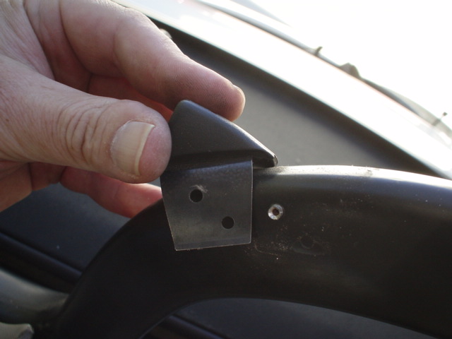

They attach with a pop-rivet in a hole in each roll hoop. The rivets are included in the mounting kit.
You should pull the roll bar padding and see if you have the holes. Some cars do and some don't. Then you have to drill them.

OK, I can get the padding to move a little on the passenger side, enough to see that I do have holes underneath for the mounting bracket. I cannot get the padding on the front of the rollover bar to move at all on the drivers side, so there must be a trick to this I am missing? Help?
It is held on by plastic sleeves that are wound on to threads protuding from the padding.
You can get a flat blade (paint scraper would do), wrap tape around the blade to protect the paint on the rollbar, and just insert between rollbar and padding and lever off (a bit at a time - taking turns between sides).
The slevees might stay in the holes, or might come out with the padding. No problem - just push them back in to the holes in the rollbar if necessary, and push the padding back on.
HOWEVER. You don't need to remove the padding at this point... Fixing the "bracket" to the padding would be no trouble at all when you get the parts. A lot easier than the other brackets on the rollbar!

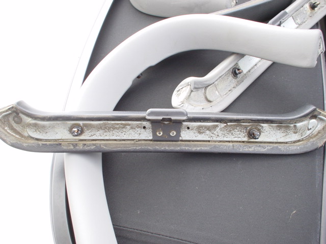

This is the middle bracket. As Mark said it goes on the back of the middle roll bar padding. 2 pop rivets for that one. The middle padding has a metal backing plate that you pop-rivet the middle bracket to.
You are lucky that there is a hole for the pop-rivet already drilled in each roll hoop. That metal is made of boron and people who have had to drill the holes said it is one tough metal.
