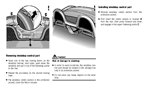

You know about the little clips at the top of the sides yes?
Well on ONE side just gently push the clip towards the middle - JUST A LITTLE (it more bends than anything, so don't force it)
At the same time push down slightly on the deflector on the same side, and ease the deflector back - this unlatches the clip from that side. Do the same for the other side, and remove the deflector towards the rear.
To refit you do pretty much the same.
Place in from the rear, engace the bottom first (you will see how it goes ehen you have it out).
Then push doen and forward to latch each side in turn (no need to play with the clip latches this time.
If it is in correctly, it will not rattle. if you've got squeaking or other noices then it might be worth running a damp cloth over the mating faces to make sure they are clean.

It's easier to show than write how to do it.
Here's what the manual says:
