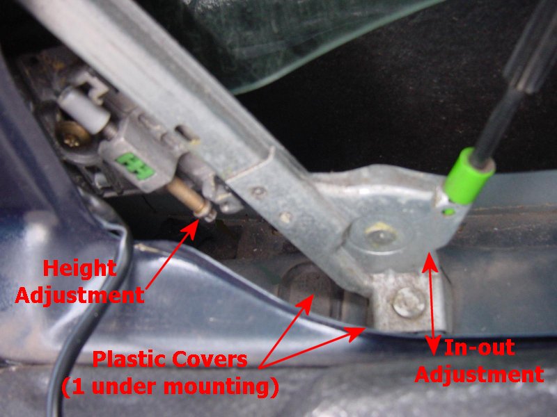

My 996 was doing the same,if you pop the rubber grommet plugs out the bottom of the doors and use an allen key,you can adjust the angle of the window,adjust the top closer to the seal (push the 2 allen bolts out towards the bottom lip of the door) and the noise will be better

Another question are these the four large rubber covers two on each end of the bottom of the door, i guess two for the front and the other two for the back of the window? havent yet taken them off but had a look and thought i would ask the question.

This is a view from inside the door. One cover is for the height adjustment screw, and the other cover is for the in-out adjustment, which is achieved by moving the bottom mount, as Peter says. There are two at the front and two at the back of the door.
