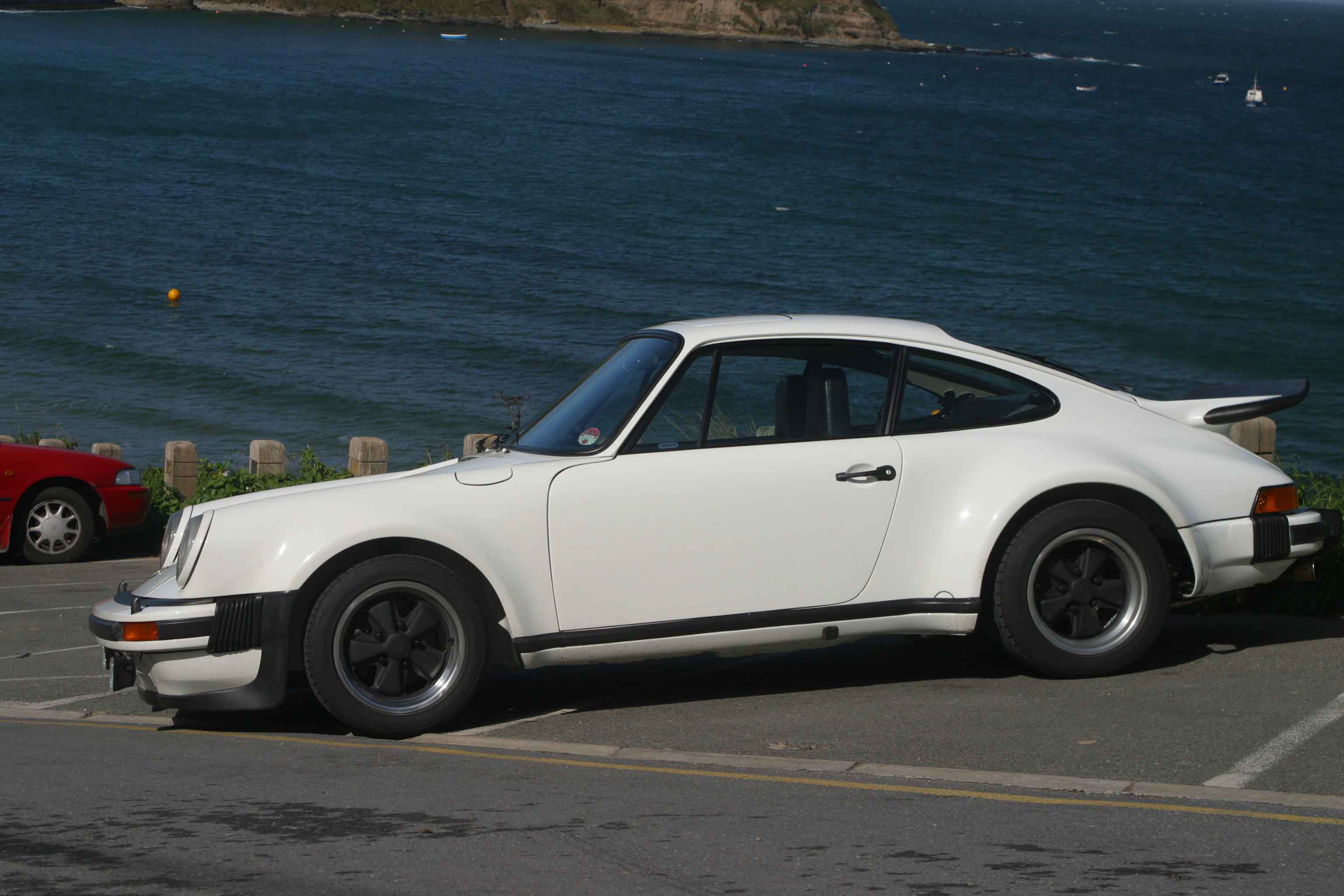

This is probably one for the boffins, but i was looking through some photographs the other day and noted that the window frames and screen inserts on my 78 turbo are a gunmetal anthracite colour yet looking on numerous press photos turbo's of a similar era they seem to have what looks like painted black frames!?
Anyone know which is correct and if there is any significants?
