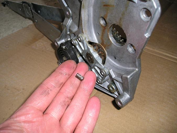

Mine chewed a tooth off the regulator - see attached. I got the glass to go up by helping it with the palm of my hand whilst pressing the button. Solution was to upgrade to a turbo regulator [;)] thanks to Fen. DON'T get bits of your anatomy caught in the mechanism, or you will bleed. A lot.

I've now worked out that mine too has a tooth missing on the regulator. Do I need a whole new unit, or just a new toothed wheel?
