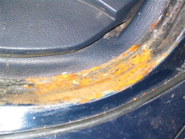

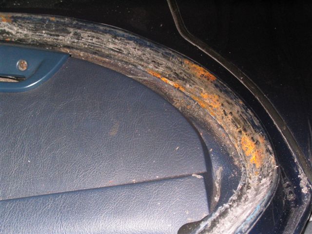

The windscreen removal exposed minor surface rust, but no penetration and a little time spent with a grinder / wire brush soon had it ready for painting. The scuttle in front of the windscreen where the wipers mount was then painted, and new rubber strips fitted between it and the wings. A new windscreen seal was also fitted.

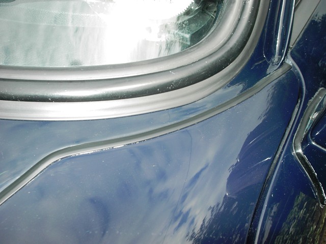

Well, what a difference a new screen makes. It is surprising how many marks there are on an original screen that you just get used to.
