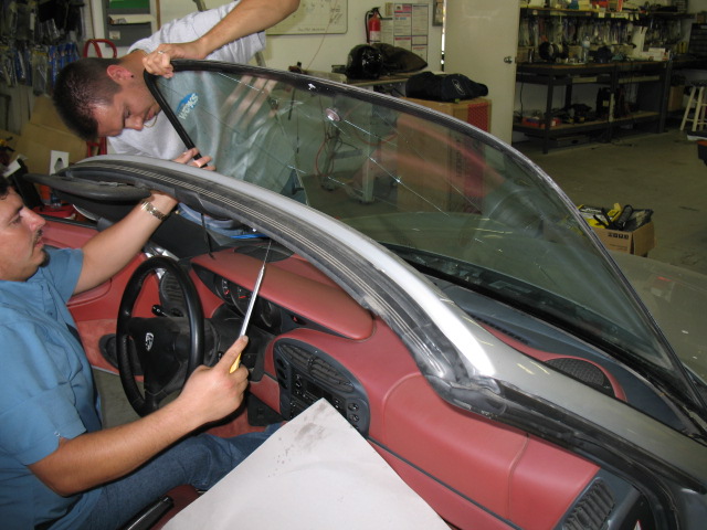

I have some experience, since windshield #3 went into my Boxster 2 weeks ago. I went to a local shop that can also come to your house or work. I have watched 996/986 windshields being replaced before and the guys at the shop did it the same way. Cut out the old windshield, clean up the frame, and glue in the new one. Takes about 1 1/2 hours if the customer is watching.

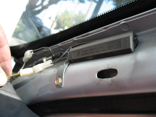

I assume all 3 companies in the US provide the screen with the centre FM aerial strip? So is there a simple contact point on the body for the aerial and how do they glue around it?

My Sekurit windshield is identical to the one sold by Porsche, except for the missing logo. There is a single wire from the glass for the antenna with a plug on the end for where it connects to the antenna booster. You can see the wire that comes from the glass in my fingers. They don't need to glue around it. Just plug it in once the glass is in place. It is covered by the plastic A pillar trim.
The other companies would also have the antenna wire in the glass or the radio would not work.
