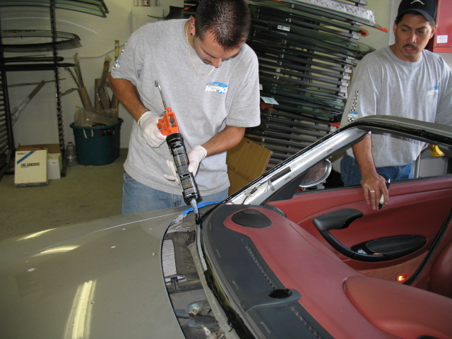

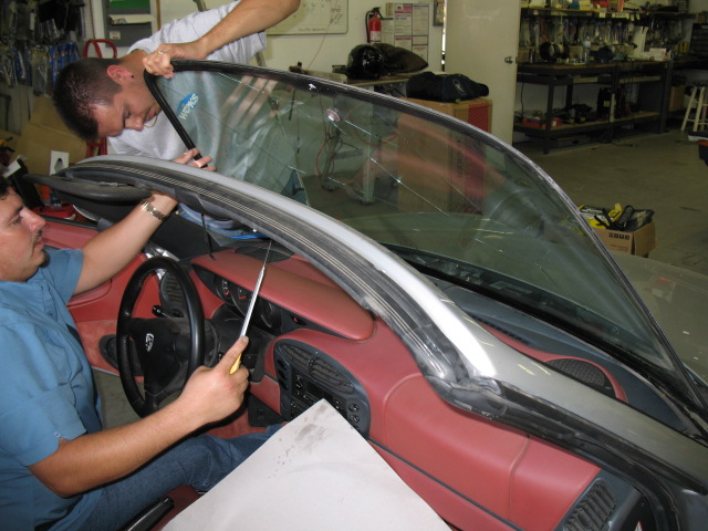

I like my windshields so much that I have had 3 of them over the years.
You can read about them here, but I don't think the pictures will show up if you are not registered.
http://www.renntech.org/forums/index.php?showtopic=10360

I have had 3 windshields in my 1997. It is a standard glued-in windshield just like any other car. For the 3rd I even helped - I stayed out of their way.
If you look at the corner of your glass it is made by Saint-Gobain Sekurit and has the Porsche logo on it. The P inside a triangle. The glass installers call this logo a "bug." You pay more for that bug because the installer has to buy it from a Porsche dealership. Sekruit cannot sell the glass to independent shops with the bug on it.
I told my installer I wanted Sekruit glass, but not from the dealership. Dealership wanted $460 with the bug, and Sekurit was $325. Sekruit was put in. It is identical to the 2 other windshields I had except it does not have the bug.
Where I live there are 2 aftermarket companies that also have glass. Pilkington and PPG, which cost less then Sekruit. When I am ready for #4 I will go with their glass. Or if I'm lucky someone will come out with a lexan windshield....
