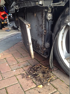

So with a couple days holiday left I decided to clean out the rads. I cannot believe how much rubbish was in there. There appeared to be the remains of a bird aswell.
The biggest pain was actually removing the washer tank. I did this because it wasn't smelling very fresh, and I had the wheel arch lining removed anyway. The last job was to remove the auxillary air pump and squirt some grease into the bearings. This has completely removed the high pitched squeal I was getting while the car warmed up.
