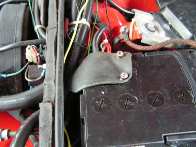

The battery is in a vunerable position on any 924. If it moves upward the posative terminal post can short out across the bonnet lid, it is only half an inch or so below it. This can happen if you drive quickly over a hump back bridge or brow of a hill. It can also happen if something is dropped on the bonnet.
My cure for this is to stick or bolt (there is provision for this on my battery) a piece of rubber over the post as shown in the image.
Geoff makes an excellent point.
You will find that the majority of modern batteries have these two small pre-formed holes (to a DIN standard so I was told) adjacent to the live terminal so that you can fit a purpose made snap-in plastic cover to guard against the 924 shorting problem. I literally picked up two in my local breakers last weekend.
