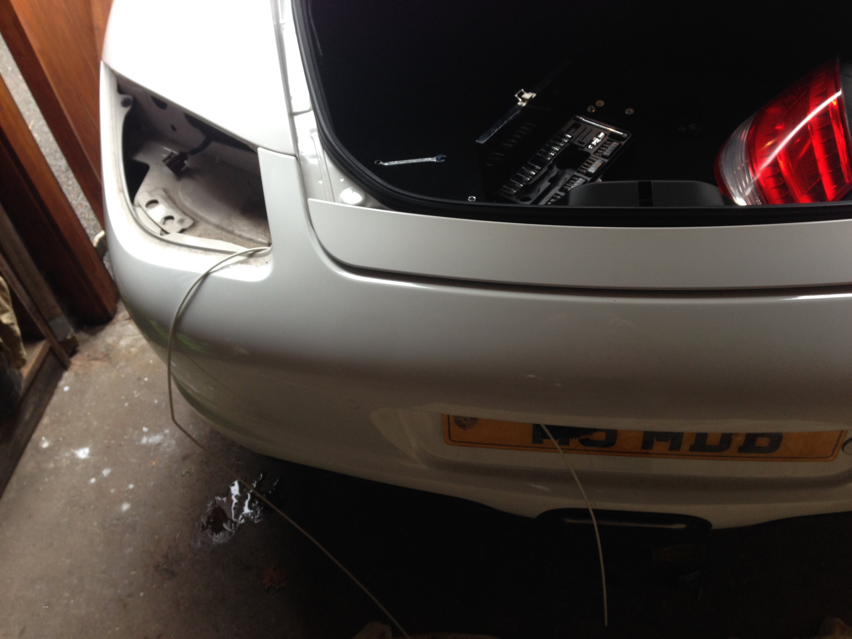

I am doing some bits to make it a bit more up-to-date. I’ve just fitted a new head unit to replace the CDR30 which has worked out well. It’s an Xtrons PE88CMPL which is the custom fit for a Boxster, almost! I intend To fit a reversing camera to it and have decided to ask a question before I start this weekend.
Has anyone ever fitted one without taking the rear bumper off?
i have just taken a number plate light off and pushed some flexible net curtain wire in to see if it will come out at the area behind the lights. I can hear it, but can’t see it. Rain has just stopped play so I thought I would come in and post this question before I take the entire bumper off and then realise I could have made this much easier.
Any help would be greatly appreciated.
Mike

Hi Having same problem with my 2000 Boxster S 3.2 Tiptronic can find out if i have to remove spoiler to get acess to screws to remove rear bumper so i can fiddle camera feed through, any tips would help. Bill
Hi Bill,
i didn't need to remove the bumper in the end. I removed the nearside rear light and a number plate light and fed a length of curtain wire through to be sure I could get a cable through.
I then drilled a hole in the bumper between the number plate lights, put a grommet in and fed the cable for the rear view camera through this.
The only problem I had was the cable for the camera (from Xtron) was only just long enough to reach the corner of the rear light cavity which made securing it fiddly. I used some tie wraps around the end of the cable to hold it in place.
After this it was fairly easy to find the reverse wire to the rear light and use solder sleeves to connect the power to the camera.
I used the curtain wire again to feed the video cable through the cabin and under the carpet to the centre console.
It all works now and I am over the moon both the new sat nav and audio along with the reversing camera.
Regards Mike
