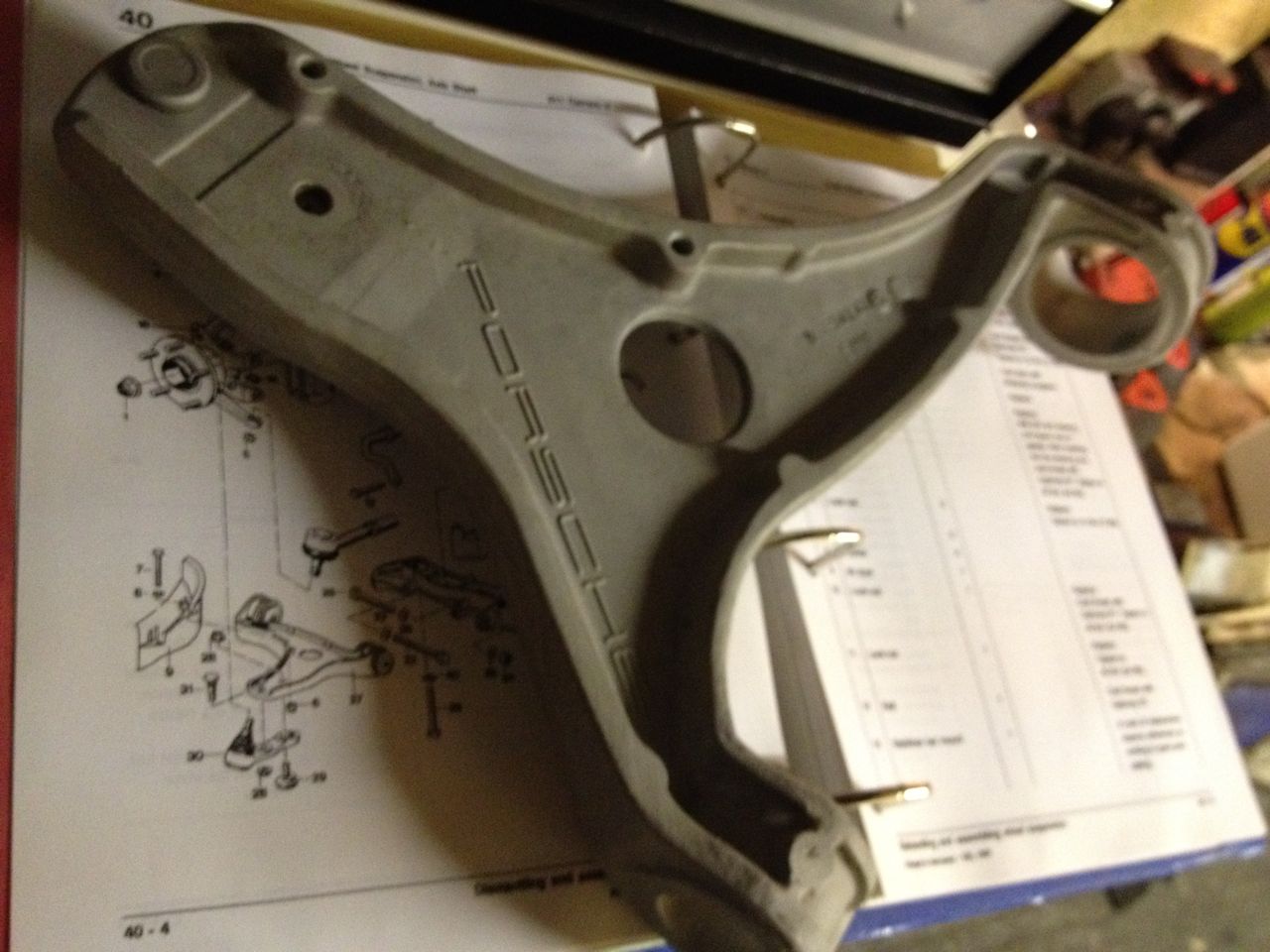

Thanks for your help here's the first wishbone blasted and ready for paint and bushes!
5hrs to remove the bushes. 3hrs the other side....
