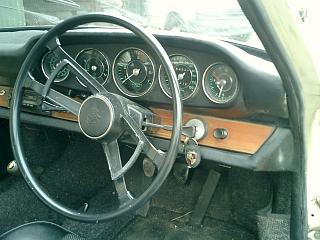

Not sure when it was fitted, I like the wood look too, may need a bit of a touch up at some stage though.

The really early 912's had painted dashes - for a '65 car I would have thought that this would have been correct.
Although its hard to see the whole dash it would appear some things are incorrect for the year.
The ingnition/key is the later type
5 dials which is unusual although not incorrect for an early 912
Non-painted dash
Makes me think either the dash IS correct and a factory extra and the ignition is a later addition
or
the whole thing is a replacement from a later 911
Seems unlikely, though not impossible that its original.
More pics of the whole thing please!
btw the teak was originally a veneer rather than Stuarts solid example jfyi

I'll take a few more snaps tonight if I get the chance, I did think that there were a few things which may have implied the dash may not have been original but none of the fairly extensive history from about the last 20 years indicates that any dash replacement has occured. Guess it could easily have been done before that though.
