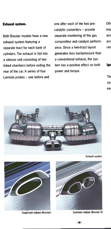

Cats are there not for performance, but to reduce emissions. This started in California in 1975 when unleaded gas came out. When the 1997 2.5 came out it had 2 cats, one on each side. When the 2.7/3.2 came out in 2000 it had 4, two on on each side. I do not think the UK 986 got our 4 cat system. I would have to look at Mark's 987 pictures to see if a UK 987 has 4, but I bet it does. A US 987 has 4. In fact the rear cats on a 987 are now part of the muffler.
Porsche did come out with a sport exhaust for 2003/4. We have it in the US. But from what I have seen on boxa.net you cannot get it in the UK.
TP info on UK 987 exhaust system for you. We didn't get any Sports Exhaust option for the 2003/04 facelift model do you have any pictures of the system?
The renntech.org link has true pictures of the factory 2003/4 sport exhaust. My dealer had a 2004 with the sports exhaust and it looked just like the renntech pictures. That is the one with the dash switch. A UK or US standard exhaust does not have the by-pass pipes on the side.
I looked at Mark's pictures of the exhaust on a UK 987 and it looks just like a US 987. You have the same 4 cats we do.
