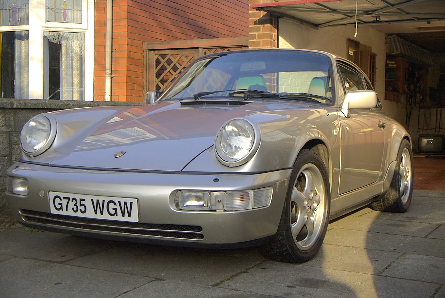

The wheels I'm looking at are the same as these,
I was thinking they were the Cup 1 type, not seen many on S2's but found this photo on Google and wanted your opinion lads, I currently have D90's fitted
What do you think?? [:)]
Oh dear. I always feel like a stick-in-the-mud party pooper when I say this, but I do prefer the D90's! They are the wheels that Porsche bolted to the car when it rolled out of the factory, and they are the wheels of choice. They look good, the size and width suits the chassis dynamics of the car, they are lighter than most alternatives and I can never really see any wisdom in changing.
(I MAY make an exception for Cup 1's, purely on aesthetic grounds, but that's about all.)
Chaps, keep it original. Ugly lumps of fibreglass, 'lexus' rear lights and hideous hoop spoilers lie only a little further down the road you are treading ...
Oli.
Widths are fine - you just need to know the offsets.
If they are round about 50 ~ they'll fit fine and look good.
If they are round about 15 they'll stick oot like Carlos Fandango Stylee, look bonkers and rub your arches (ooh er missus).
Found out today they are ET15's [:mad:], bugger!! Never mind, thought I was onto a winner as well as the lad told me they were fitted with spacers on the 911!! Omitted to tell me they were on a 911 with turbo wings grafted onto it, so obviously needed spacers anyway!
