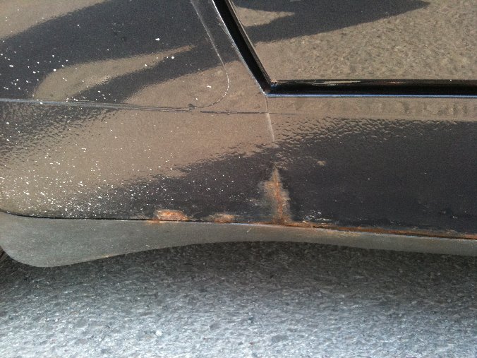

that pic is certainly not surface rust, as already said the cills rust from the inside out so those cills look shot to me. I'd budget £1,500 to sort all the bodywork, so I think the car sounds expensive at £3,200. I'd get a quote from a bodyshop before you commit to buy.
I looked at a 944 S2 today that seems to be mechanically excellent, with perfect history (just over 100k miles) but has significant rust bubbles along both sills, the rear edges of the front wings (by the inner plastic arch liners) and one one wing along the join with the bumper.
The knowledge seller says it is surface rust and will be cheap to fix but he just wants rid of the car for bona fide reasons. Given the rust a deal can be struck for ~£3200.
But with this level of rust (all other panels seem solid) would you just walk away?

Thanks guys. You are confirming what I suspected. Another photo - of the other sill/cill (sp?) I am amazed that there are S2's changing hands for sub £2k though.
Its definately fixable but at a price, I would say that £3200 is too much considering the cost to repair it properly. You would need to work out how much an already good one is going to cost you against the price of one with shot sills plus repair, but instinct would tell me that its not just the bodywork that has been neglected on this car. Looking at the fotopix you have posted I would walk away from that car unless it was very cheap, the front wings look pretty normal as most of these cars look similar but add to that rust at the front bumper and sills and youve got yourself a big bill to get it all right again. Edd

In principle i'd say no, and in some screwed up way it might be a good idea to buy a cheap 944 that needs new sills and have them replaced than pay a good price for one that appears to have decent sills only to find they need some work a couple of years down the line. Getting the outer sills done properly by an experienced bodyshop is a grand or so job using OEM parts. I think £3200 is too much for a car needing new sills irrespective of mechanical condition. It is important to get the sills done by a body shop with experience of this specific job. THe Porsche specialist near me (PH Sportscars) used to get a nice amount of knock-on business from people getting their 944's sills sorted after ropey jobs after using their bodyshop down the road. It's better to pay for the job once. The only way to be sure that you are buying a car that is rust free in those areas is to get an endoscope down the sill to actually visually confirm they are rust free and get the car up on the ramps to have a good butchers at the condition of the wing bottoms. I'd echo Ians comments - those panel gaps look dodgy from the photo's you've posted. Not sure if it is just camera trickery.
I would actually look for a cheap 944S2 with rusty sills, but then I can weld, paint and make my own repair sections. I would expect to see a lot knocked off the price for that amount of rust as it is not just surface rust- both sills need replacing on that car- at significant expense including the paintwork! and I agree, the front wing is not aligned with the sill, that looks dodgy, check the car for signs of accident repair and possibly do an HPI check. I would buy a 944 with rusty sills but not one with rusty sills that was still bent from an accident!

Hi James, if it had T and T, I would be looking at 2K max for it. Where the stone chip is bubbling under the paint, that is moisture getting in underneath it. The mositure gets into the seam at the rear end of the sill and creeps along to the front rotting nicely. All the drain holes will probably be blocked in the sill as well, they are usually full of rust! If buying it, check carefully the front and rear towers of the jacking points and make sure they are at the same height, that also gives a good indication of how dodgy the floor pans are. Check the join between outer sill and floor pan all the way from front to back as this needs to be in good nick if you have to replace the sill, if not, you have to chop into the floor pan. # Corrosion inside the bootpockets either side where the battery sits is usually due to leaking lights or hatch pins seals, not a hard job to sort out. Make sure all grommets are in place at the bottom of the spare wheel well as that can let a lot of water in but helps let it out if all the seals are leaking! John, the front of the wings where they join the PU is quite a common rot spot, watwer gets past the wheelarch liner and sits on top of the return in the wing where the 3 bolts go through. I have a few cars here with plenty of rot there, not a major job to repair as they are easy to get the wing off, the biggest problem is getting a good fit along the PU after welding repair, a spare PU is handy for this!!! Alasdair

James, The alignment of the wing is off, which may be why the front wing is rusty, i.e. poor previous repair. Repair to the wings and rear quarter panel need not be expensive. However, the sills could be, especially if the rot has reached the floorpan. It would be worth looking down the b-pillar from the vent hole and if possible lowering a compact digital camera (camera phone might work) down and taking a forward facing shot along the inside of the sill. Small hands required! What's the rest of the paint like on the car?
