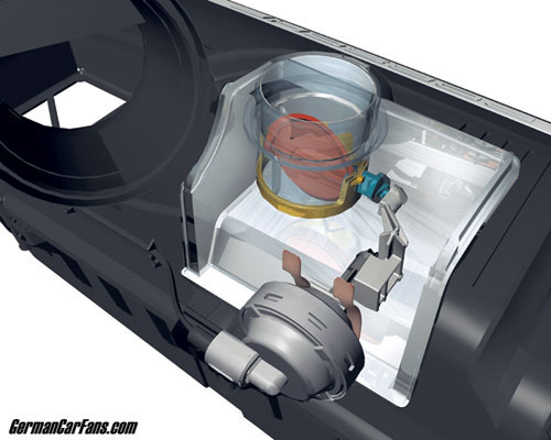

What does the resonator do? I recall the brochure saying it modulates air intake to the inlet manifold or something.
Thanks.
Quote:
The new, individual-control Helmholtz resonator accommodated in the air filter housing is a typical feature of the acoustic refinement that has gone into the new power unit of the Carrera S. This acoustic damper offering approximately 0.3 litres of additional resonance volume is integrated in the intake system between the hot-film air mass meter and the throttle butterfly. The Helmholtz resonator is activated when accelerating between 5000 and 6000 rpm, reducing oscillations of the intake noise under such conditions within the 260 Hertz frequency range. Porsche has already registered this new system for a patent, the new 3.8-litre power unit benefitting as a result of this technology from a deep, throaty sound under all engine loads and at all speeds, without any aggressive peaks.
