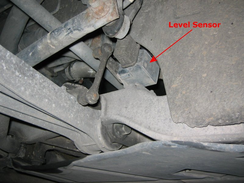

While my C4 was in PSR Automotive yesterday having new rear Contis and a full geometry reset (thanks Paul for a superb job- the car feels so much better!) it was noted that a sensor on the wishbone for the Xenon Headlight levelling was broken.
I can't find much info on these beasties nor how much it would cost to repair/replace.
Has anyone else had a similar issue?
It is usually the mounting bracket on the wishbone or the plastic link which breaks, and they are available separately (£2.22 and £13.51 respectively). If the sensor itself has broken, these are £46.70.
Pic of front sensor:
Not too bad then, in the great scheme of things!
Thanks once again for your speed of reply and encylopaedic knowledge :)
