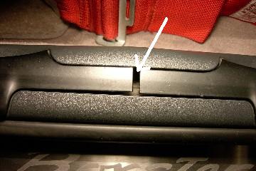

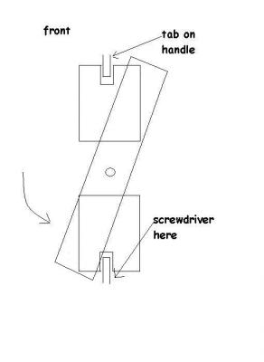

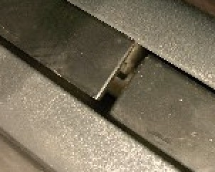

There are two pictures and a drawing as the pictures are not very clear. Picture 1 looks forward into the gap between the levers. The second picture is an enlargement of the gap. The drawing hopefully shows what you see when you are looking into the gap.
Looking forward into the gap you will see a metal plate that has a U-shaped cutout. You will see that a part of the handle sits in this cutout. The locking mechanism is a plate that rotates underneath the U-shaped cutouts thus preventing the handle from moving.
To unlock the lever you rotate the plate out from underneath the U-shaped cutouts. It is easiest to do this under the bonnet release lever. You reach in with a thin screwdriver or an awl and push the plate from right to left. This unlocks both levers.
If you give up then you have to go for the emergency release cable which is behind the headlamp unit and accessible by removing the wheelarch lining.

Wow, thanks guys, especially Black 80XSA. I followed your instructions on levering the CAM....worked a treat[:D]. So relieved when i saw the bonnet open. Anyway, removed the battery and put back my old one temporarily so as i can get it in for its service tomorrow. Think i will try GT1in Chertsey...don't know if anyone has used them before...spoke to the guy on the phone seems very nice [8|].
