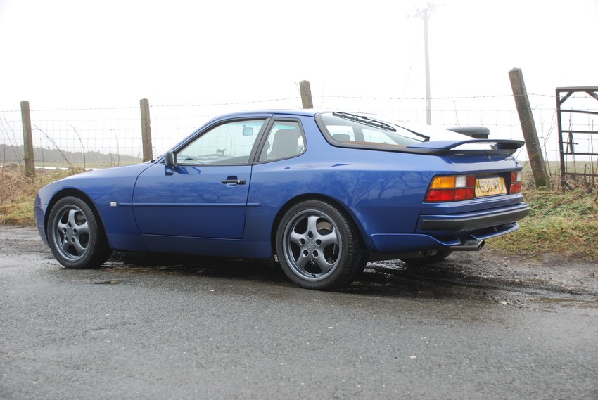

I am considering an S2 as a daily driver in about three months time so thought I would take an early look at a couple around 3 "" 3.5k which sadly required a lot of work. I an not looking for perfection, have I been unlucky or do I need to look at something at 4 -5k.
I know it's no guarantee and would have a PPI, buy on condition etc. If I was currently in the market, the enclosed tick most of my boxes, any thoughts?
http://www.pistonheads.com/sales/977473.htm
looks like the twin to my s2 very nice..i would spend £5000..to £5500 for a good one with service history...70 to 90 thousand miles..black or grey leather..
Looks and sounds right in a very nice colour,check the sills for rust and the bottom of the front wings,the camshaft drive is via one cam only then drive is transmitted to the other cam via a hydrualic (engine oil pressure) tensioner the chain which drives the "slave" cam passes over a nylon pad which wears and introduces slack in the chain this can damage the camshaft drive teeth and/ or jump sprockets if this work has not been done get it done should you buy !!

looks a nice one - no interior shots which is a bit odd, and I don't think blue was a limited run .......

It certainly looks the part in those pics and I'd be happier spending a little more on a good car ~ you don't have to spend a lot more and assuming you keep it good you'll recoup the extra when you sell.
Usual warnings about rust (as above), cam chain / cam sprocket condition, callipers and clutch.
Linen leather marks easily and shows its age far more than black.
