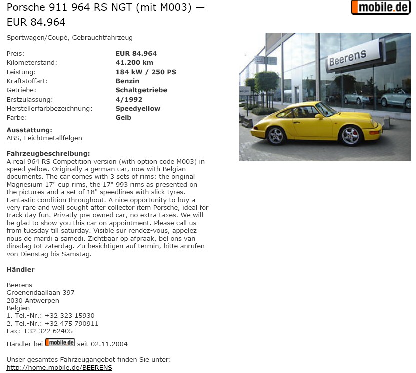

Car appeared on mobile.de in January. Color Speed Yellow. See attached ad
K
This yellow car is advertised on mobile since mid of last year.
First for 75,000 Euro then 2 days later for 85,000 Euro.
