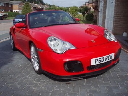

Hi All,
Attached are pictures taken today with my phone after grilles were fitted by Porsche Centre Cambridge.
Or at least I hope they are......
They removed ALL existing plastic ones, including the centre piece which I have retained should I ever require to return it to it's original standard spec for resale or warranty purposes!
I must say that I am very pleased with the quality of the grilles, the only criticism (constructive, of course) is that both the side grilles do stand a little proud of the bumper in the top left & right hand corners when looking at them 'head on'.
I am sure that this is in part due to the curvature of the bumper at these points & the 'flat' design of the grilles.
However, I am positive that they will offer a very high degree of protection that the 'originals' could not...
I look forward to any response.
Paul (kasspa)
Not sure they have been fitted correctly. They are designed to fit slightly recessed like on my 997 (see link)
http://www.porscheclubgbforum.com/tm.asp?m=507670&mpage=2&key=grills&#532151
Hi Geoff,
Zunsport would have fitted them free but only cut out existing grilles in order to push fit their design into place in the lugs present in bumper.....
I'll see what folk say upon seeing them & decide if any improvements can be made, perhaps even a trip to Zunsport too!
Paul
Um, there aren't any lugs on the bumper. The original plastic items are held in place with a sort of panel clip. I'd ask PC Cambridge how they have secured them. It looks like the same panel clip could be used for the ZS items. If so, you could play about with how much they protude (or not) from the bumper.

No not yet made them sit better but not tried too hard as I dont want to damage paintwork on PU....
I will fwd emails from Zunsport if I haven't deleted them!
Cost was £195 including discount, compared to design911's £140 for moulded mesh I think they are excellent value despite the problem with the fit....
OPC did remove PU to salvage existing grilles.
Zunsport would have fitted them free but just cut out side grilles to remove them.

Not thought too much about taking them out as I'm hoping most of the 'muck' will be prevented from getting in there in the first place.....
The DIY process of fitting them yourself was a simple operation but how much prising to get them out again without damaging paintwork will probably be a risk.... or it's bumper off, I guess!

Haven't managed to get up to Zunsport yet but grilles have already prevented debris from entering the vulnerable area & definately NO sign of temperature increase on gauge.
