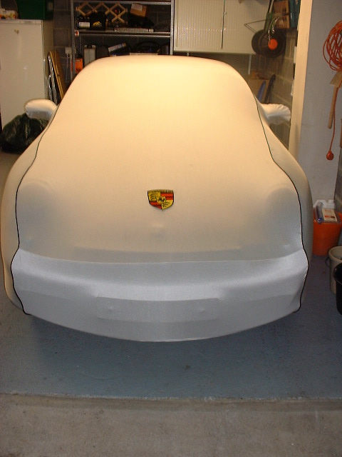

Just zymoled and put away out of the cold and wet.
The cover is from Classic Additions and fits like a glove

That cover looks really good zymol'd whats the car look like? :ROFLMAO:

It doesn't appear to be 'plugged in' so I assume you don't have a battery conditioner (trickle charger).
With the alarm (and in my case tracker) you can expect the battery to run down quite quickly.
I had to ge Porsche Assist (RAC) out Saturday morning at 6.30am to start my beast and it had only been standing 4 weeks.

I suppose having invested in a winter woolie for it then I guess you'd want to use it .... why not get a refund and use the car instead? More fun IMHO ....

It`s a nice looking car without the cover and as JCB said use it
I use my car come snow wind or rain, (very carefully in the snow) but there again it`s only a 911
