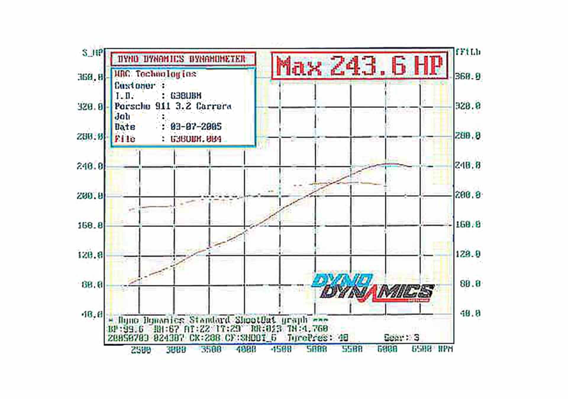

The dark shading is there for every car - so its not just me.  John's video is more illuminating as you can see oil smoke from my car on lift off - as I have said, there are "issues" to solve post rebuild.  Oil consumption indicates something like a pinched valve stem seal and dyno indicates there is still hp to be found.  Pity I couldn't get AFRs from Weltmeister which would go a long way to solving the second issue.
Richard - Didn't figure it was just your motor, or even your motor! Imagine it has slowly increased over a period of time, unless someone had a serious oil control problem eh! But I guess I was right about it being oil.
I've had a go at your plot. Obviously no problem increasing the size, but not sure the system will except it! I'm giving it a try! Don't know exactly how it works.
I assume your graphic is a facsimile? Did you upload it from a photograph or a scan? It lacks ............. sharpness. What's the original like?
I'm not familiar with the valve stem oil seals. What type are they? Simple, complex, one piece, multiple ........... ?
