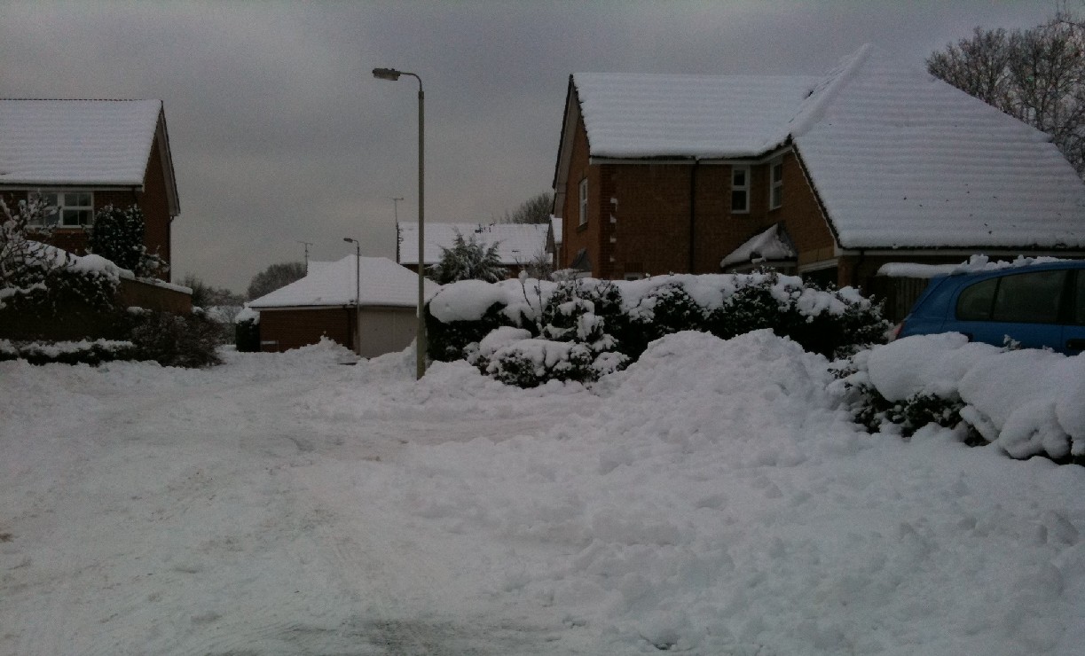

Living in Reading we have had lots of snow in our close, so far the porsche is the only one that's managed to get out to get supplies.
Most of the neighbours have new'ish cars but couldn't get up the slight incline to the main road (not that that's bean salted either!).
They didn't think the Porsche would do it but she drove straight out and back down again without any problem.
We all went out on Wednesday and cleared the road but more snow came down that night, so we gave up (Picture attached).
