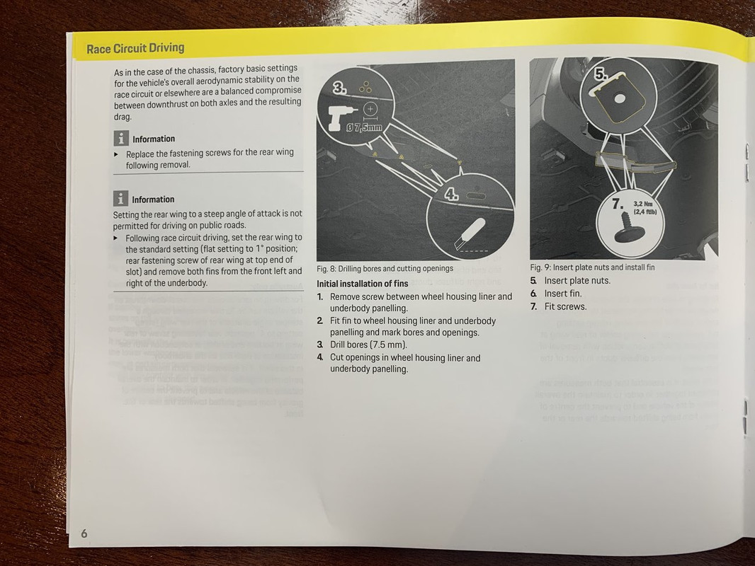

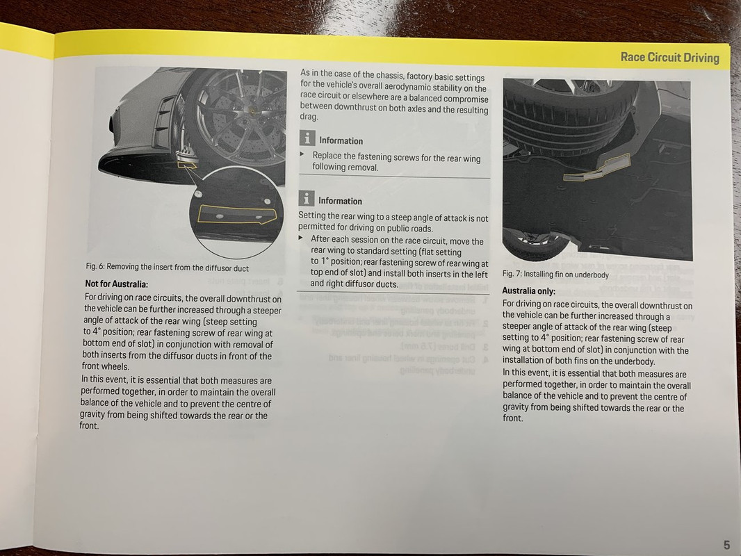

Twinfan said:Ralph,
It looks like we do have the same aero adjustments on our 718 GT4s. There's a separate manual detailing track driving and it describes the front aero and rear wing adjustments. Not sure why they're not supposed to be used on the road though?

I thought you weren't touching the aero Dave, why the change of heart? Also, what did you do with the screws for the wheel arch pieces? I just put mine back in, without the plastic.
Regarding the driving on track supplement, I didn't receive one either, I called the OPC asking to order one and was informed that Reading have about 1300 on back-order. I've put my name down so will see when or if I get one through the post [

Hi Oli,
I thought I'd give the aero a go, no reason not to really especially as it'll be going on track. I've noticed that all the Mathey kits add more aero so I thought it was worth a shot.
I completely removed both the screws and the plastic pieces and have stored them safely away so I don't lose them. I guess the threads could get dirtied up but I suspect I'll never put them back in as long as I have the car. If they do ever need to go back, the threads can be cleaned out. I'd rather that than lose the parts!

Can't you put the screws back in without the panel?
Nick
Nick_USA said:Can't you put the screws back in without the panel?
Nick
Yep, that's what Oli's done. I'm just being paranoid about losing them if they rattle loose - the panel has a grip on it to match the underside of the screw, which the hole left behind after the panel removal doesn't...
