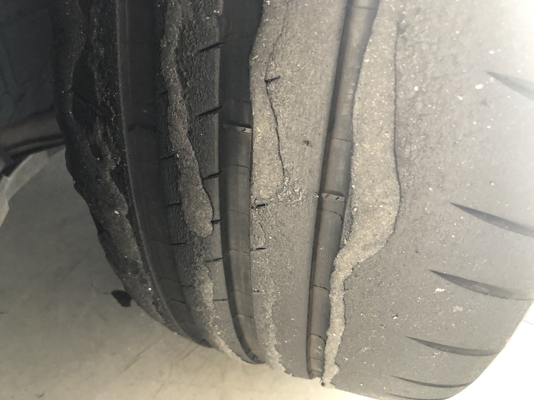

Now that is interesting as that just about describes my situation! Also the tyres are no longer feathered but are roughened and do feel harder. There is still plenty of tread on them though, so it looks like I will haveto sacrifice 4s a lap for the time being. I do have another set waiting to go on which I bought when Michelin were doing a cashback deal.
You say feathered?
These are from one Silverstone GP track day even after driving 200 miles home - I removed over 800 grams of OPR off the four tyres. Hot days and others' slicks or really soft rubber can do this.
that almost looks like pickup rubber from the track. What I call feathering is if you imagine a pine cone, run your fingers over it one way and it's smooth, the other way rough. Hope that makes sense?
Mine was not feathering….just showing another on track tyre damage issue
