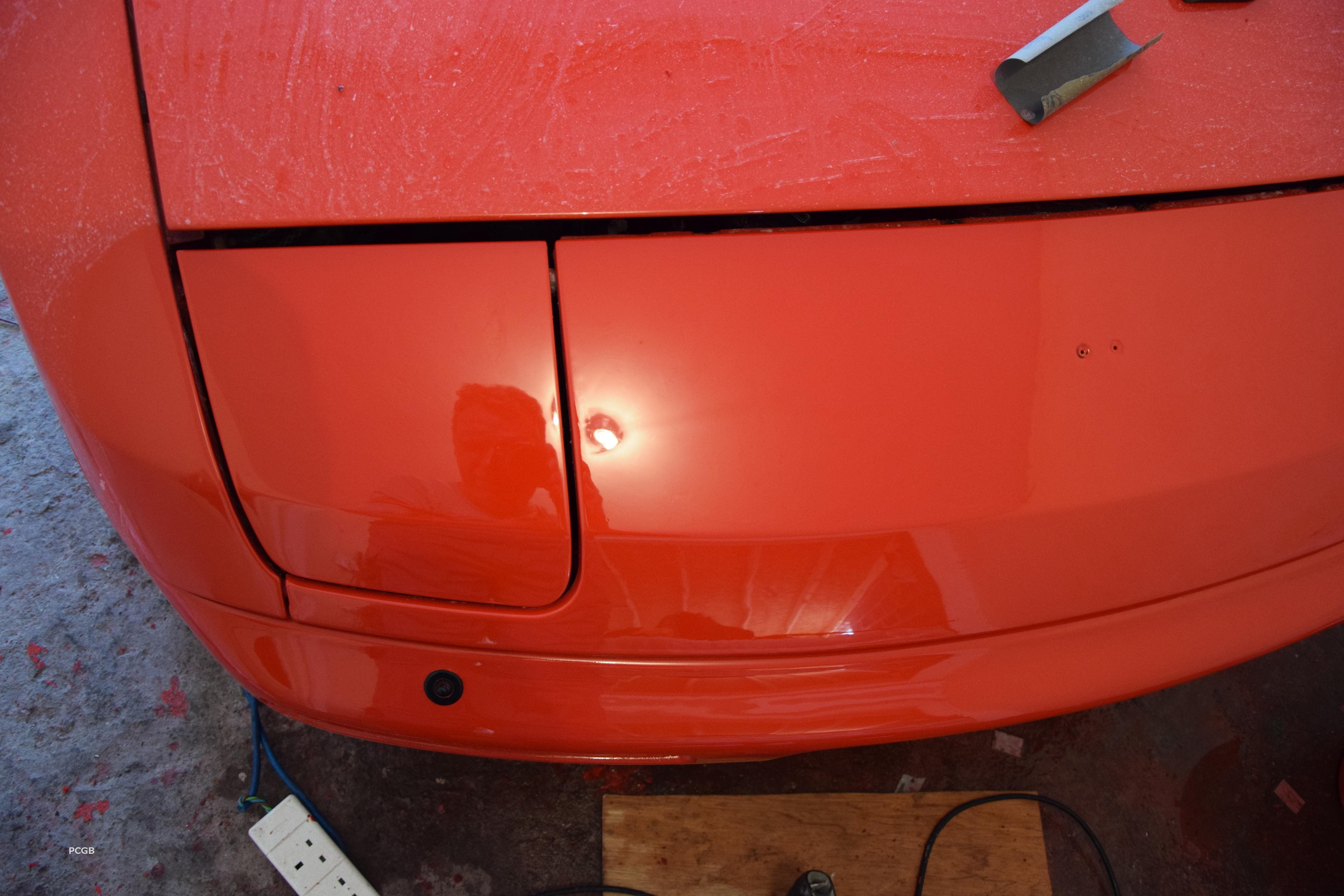

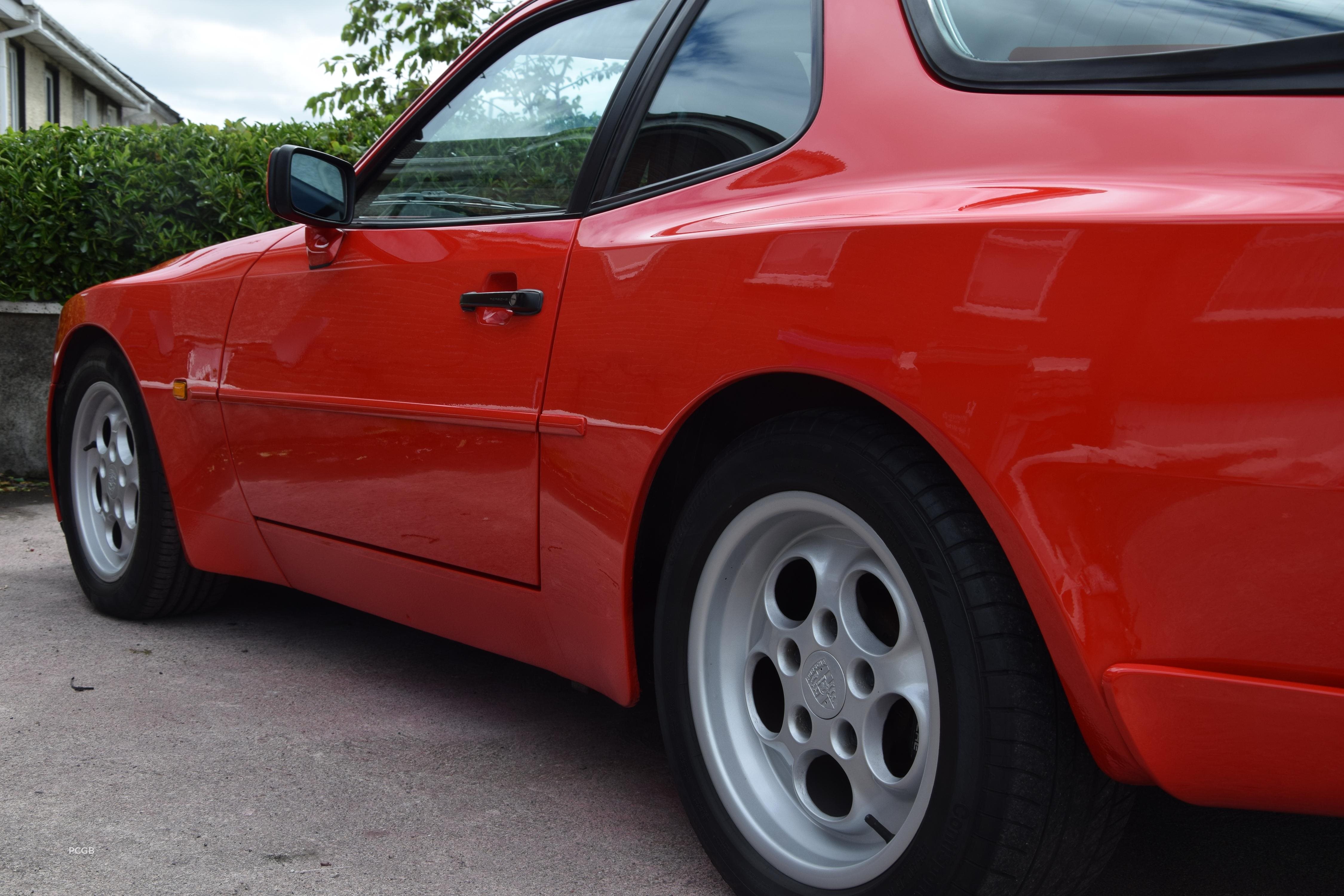

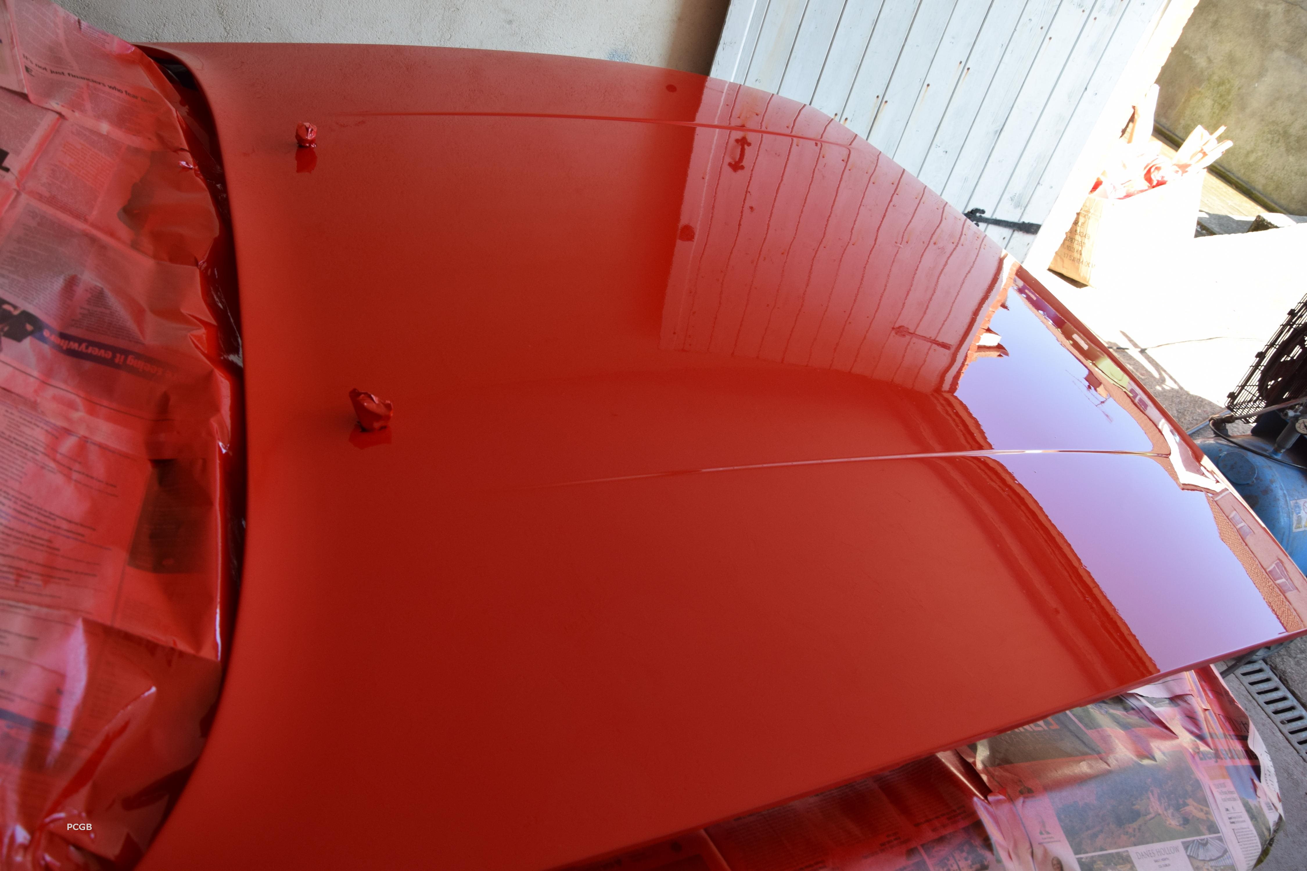

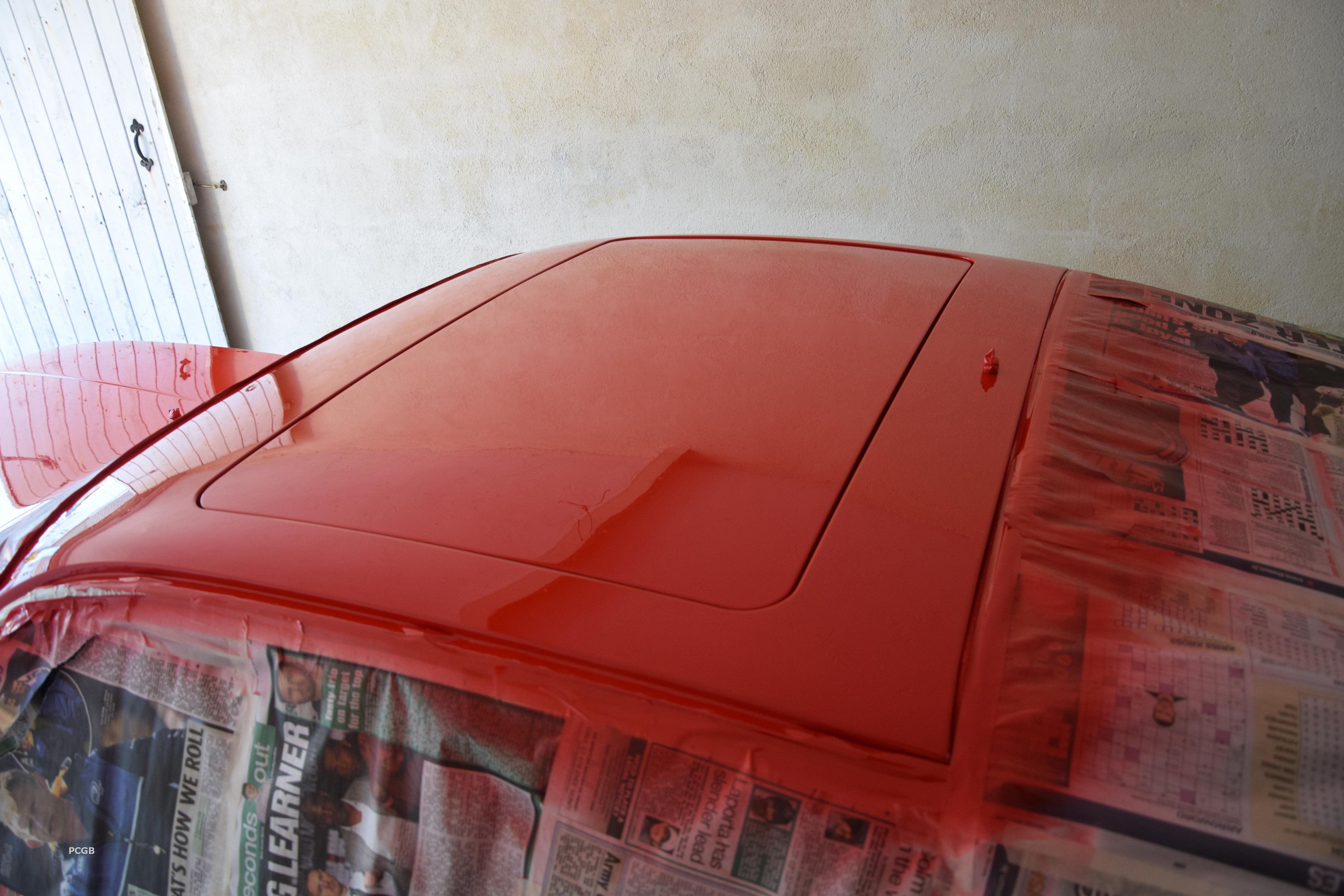

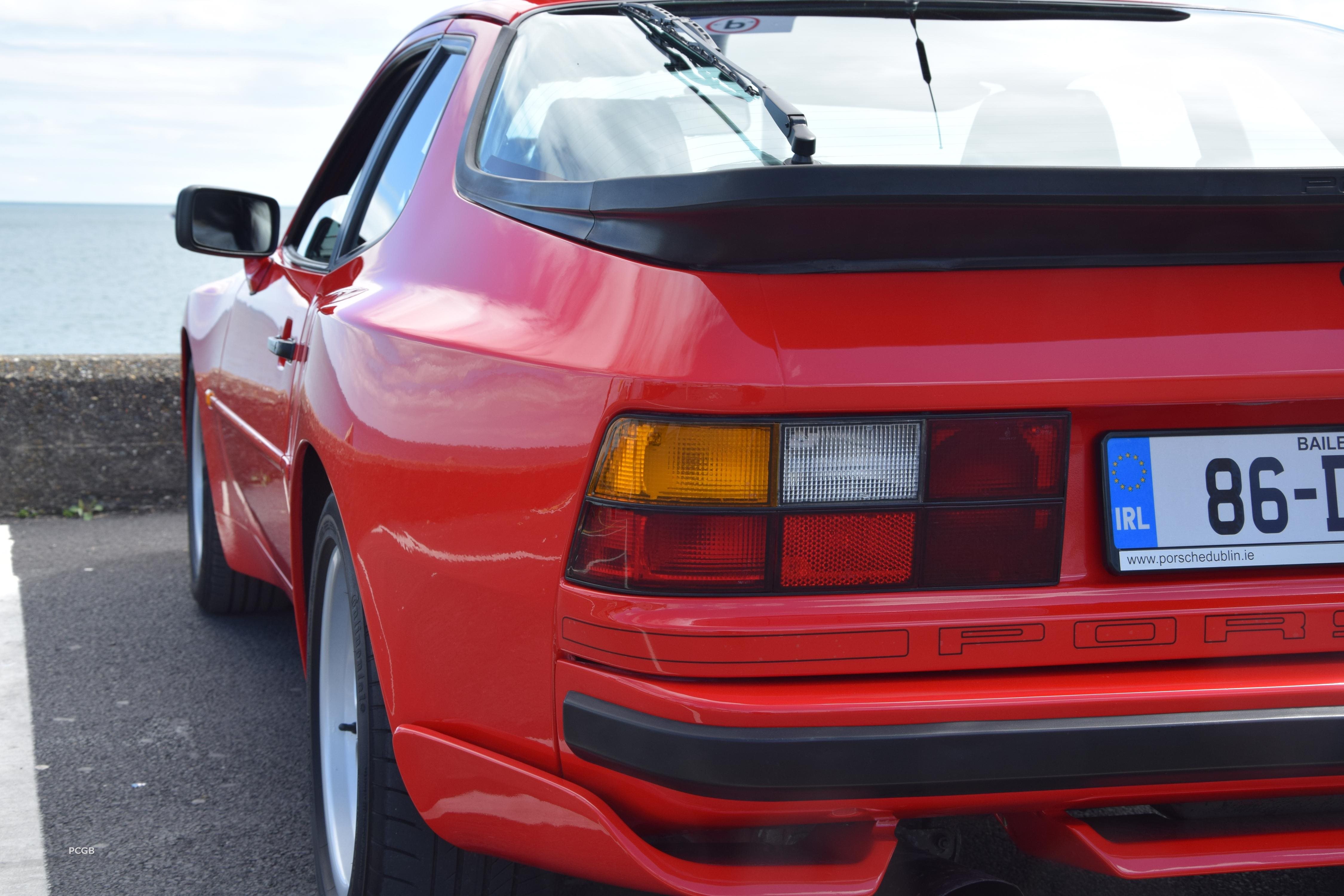

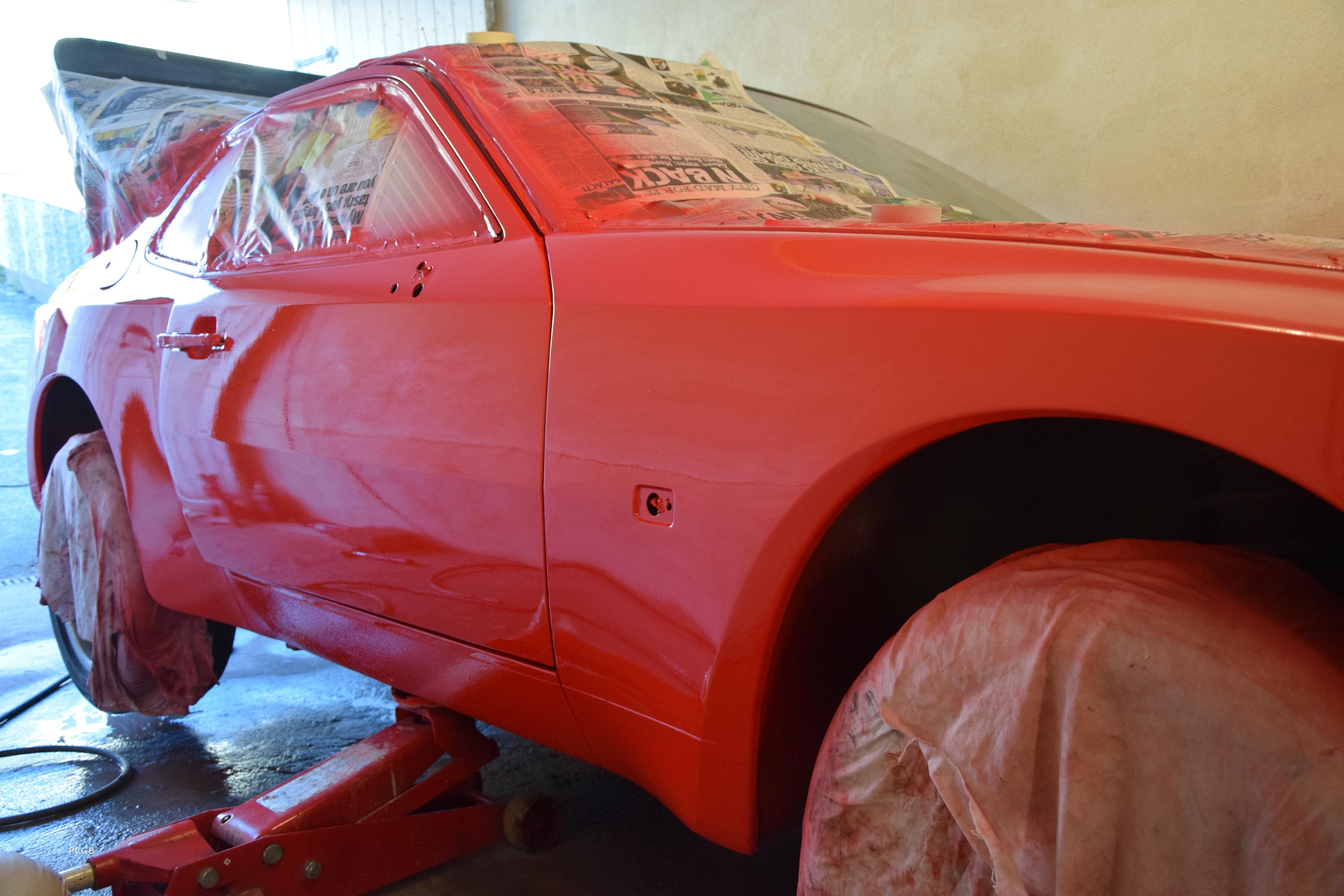

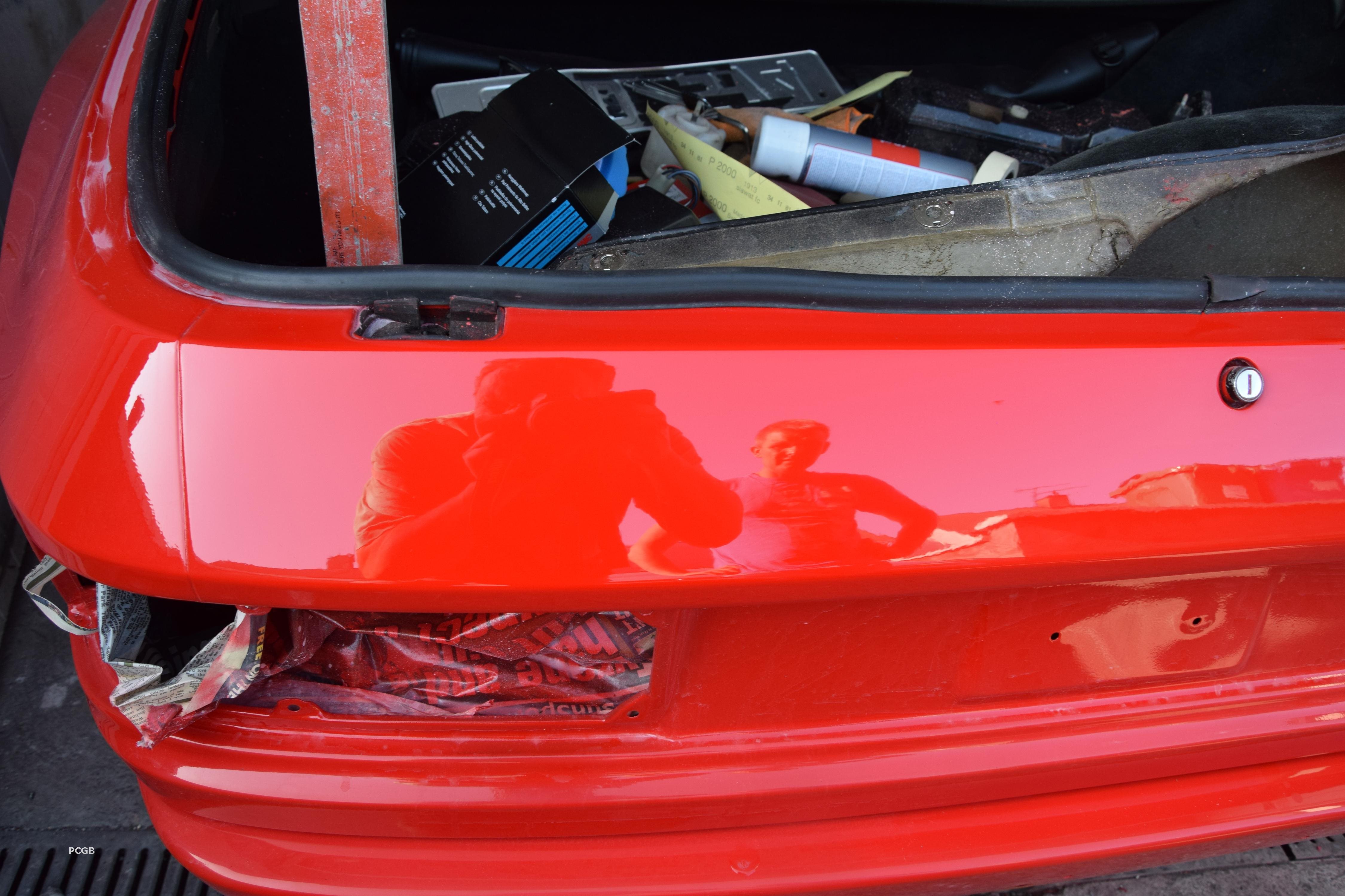

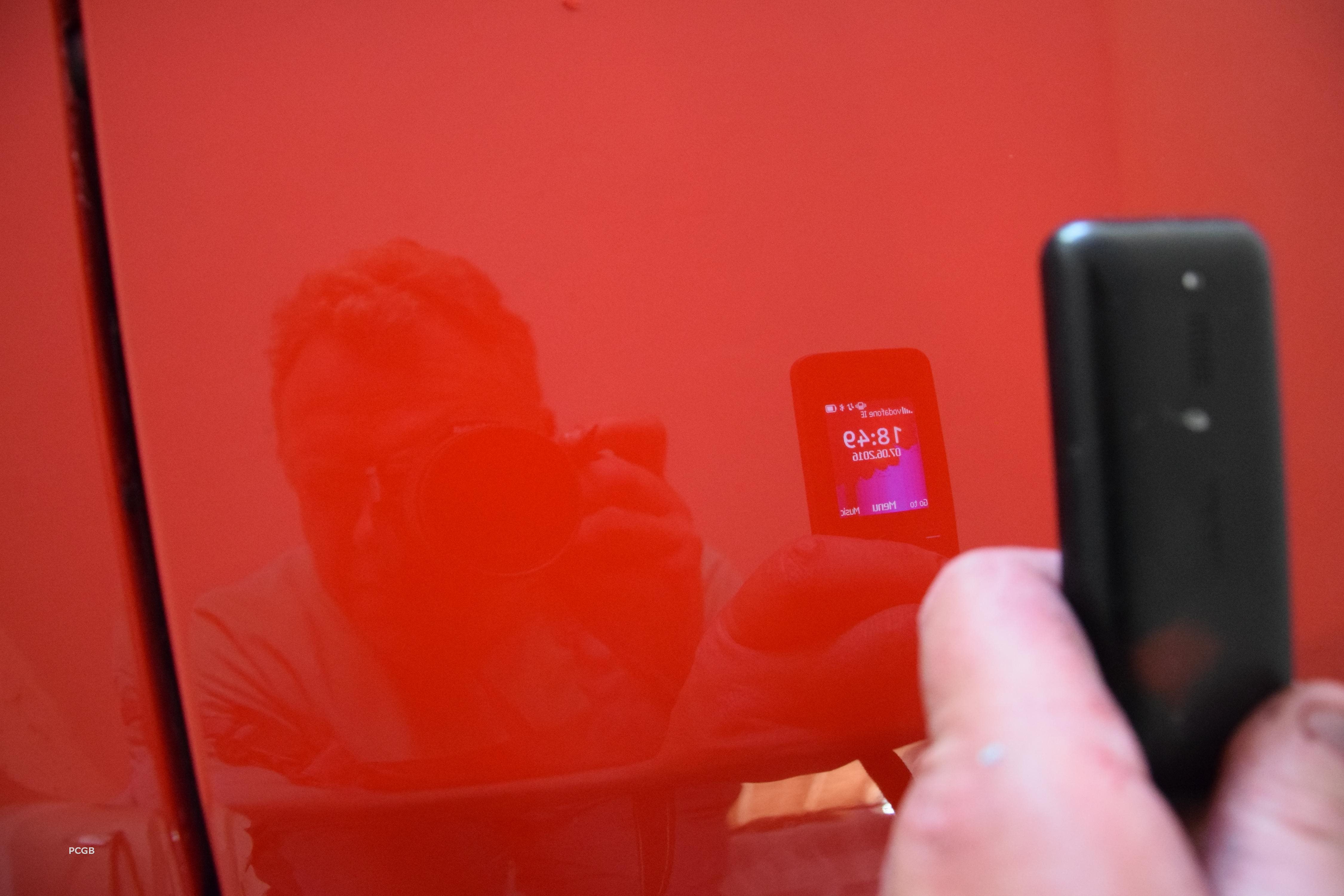

My brother picked up and 86 turbo last year for a song (€4,500 Euro ) Car drove well with good interior etc but the paint was letting it down. This past summer I decided to give it the respray it was crying out for...He was thrilled when I handed it back[:)]......Some pics[attachment=p1.jpg]

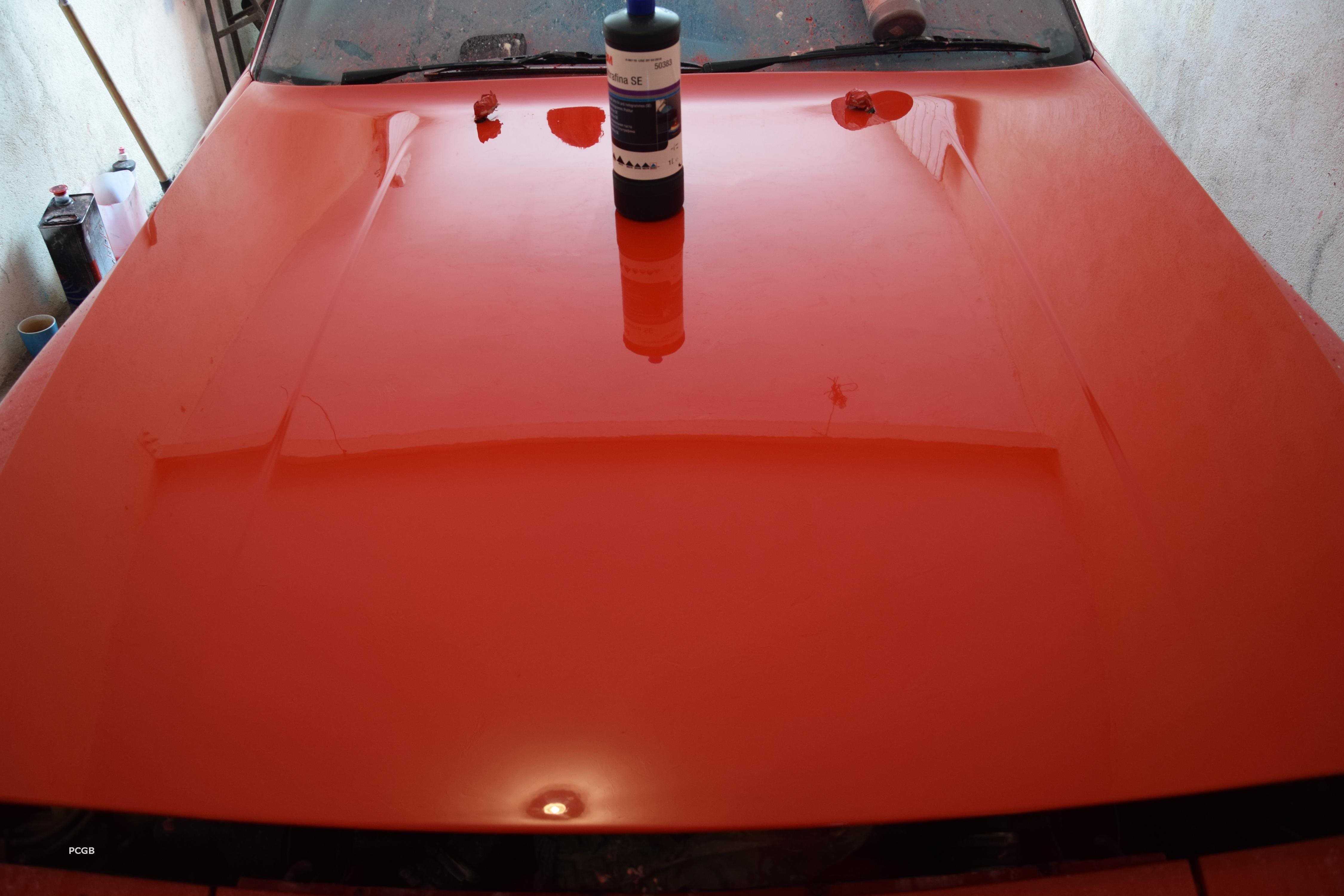

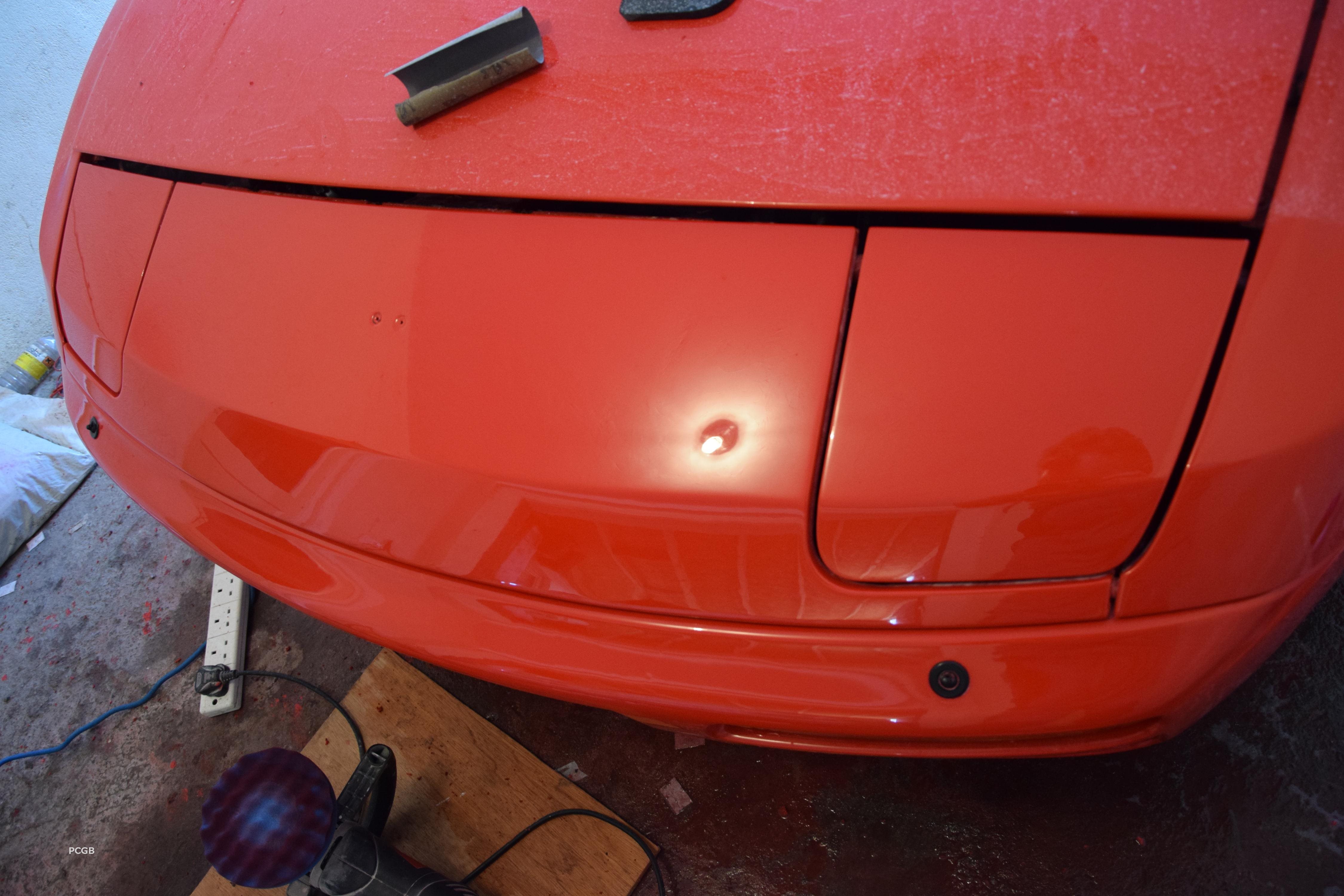

Car was painted with Lesonal Paint ( Single Stage ) It is a high quality paint so will hold out for many years. The paint was cut with 1500 grit wet and dry then Compounded and then given a finer polishing. I have another couple of Porsches waiting to be done an 89 S2 and an 86 924S....Will post pics as they progress in the near future.[;)]
