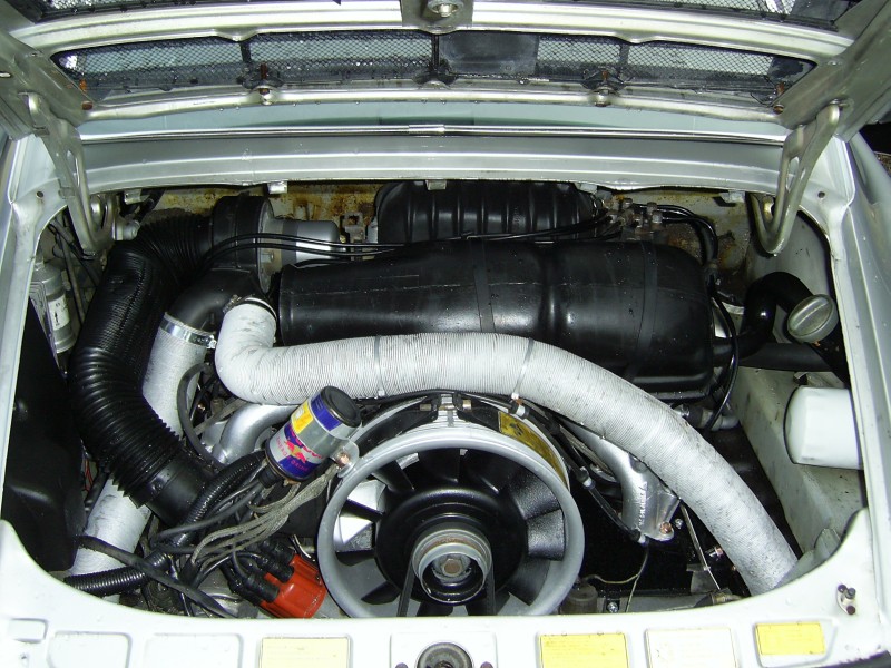

Well the engine is all re-built. Just waiting on a couple of tinwear parts before puting her back together.
Here's a pic or two
Yeah pleased with the result thus far. As for the cost I have not finished adding up. we are looking at over £5000 so far and I have the labour to go yet. Once it's all done I will post a report here.
