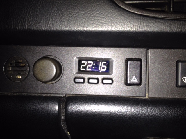

I've just received a replacement clock screen from Alasdair that I plan to fit tomorrow, I'm content with doing the job although I've never done it before.... Do you want a thread started with photos or is there one already as I can't see a detailed thread anywhere?

Good old Clarks, I couldn't have written and photo'd it better...... I wish I'd read it first!
The job is actually really simple, just take care with removing the fan speed and temperature switches. The temperature control unit cover MUST be removed very carefully as it is pretty thin and I was a bit ham fisted and slightly bent one part of it (luckily it didn't snap and once back assembled there is no bend "crease" visible).
Once I'd rebuilt the clock and mounted it back onto the fascia bit I realised I hadn't replaced the White paper piece that does whatever it does to smooth the light across the whole screen. I stripped it all down again, fitted the paper sheet and reassembled. Although I took my time as this was my first dismantle and tinker, I reckon if I had to do it again it would probably only take about 10 minutes to complete.
As mentioned by papamantra, once complete its extremely satisfying to see a working clock for once.
If you are thinking of changing your clock screen go for it, you won't regret it. Just mind the thin and delicate bits!
