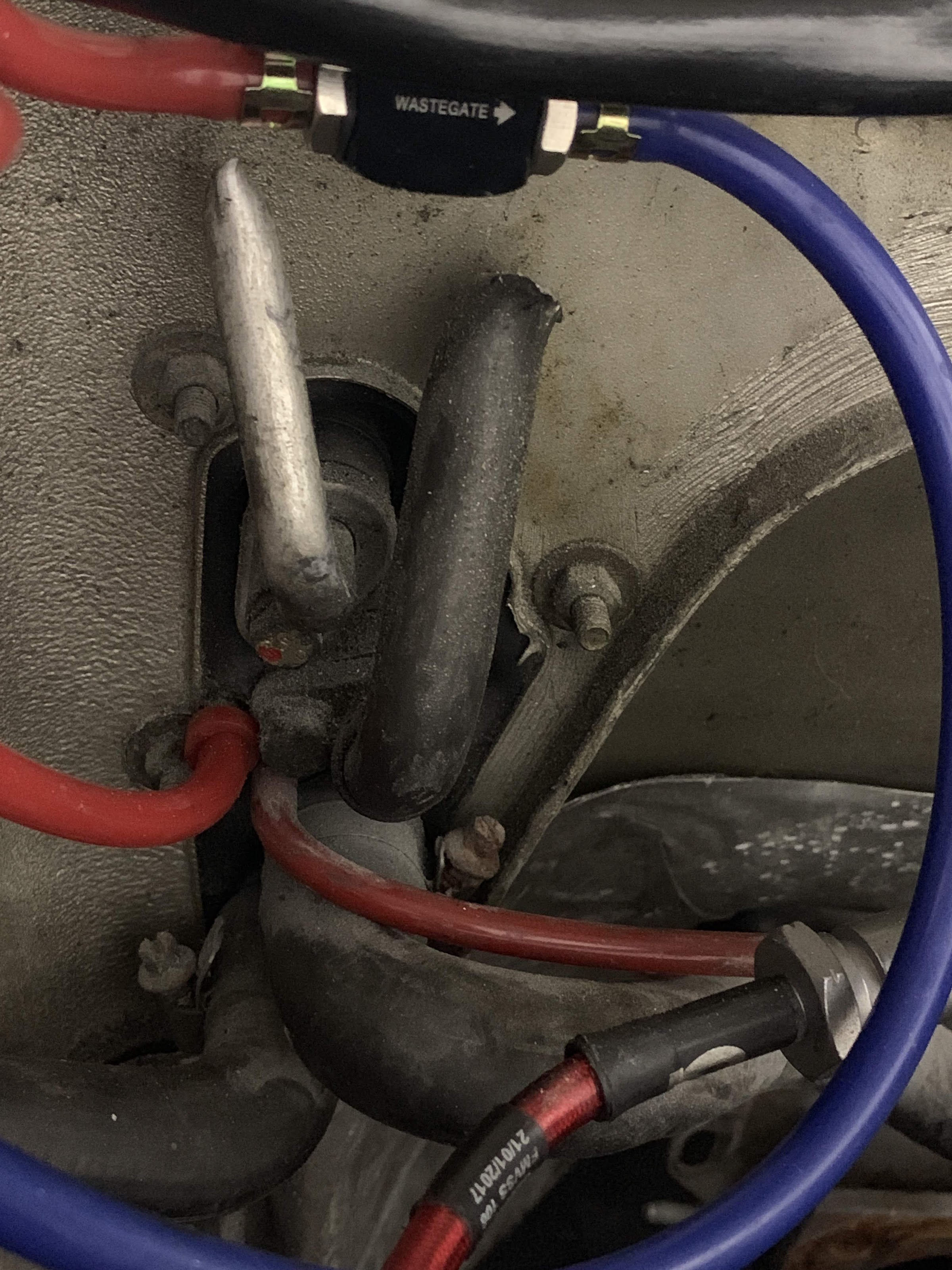

Had a knock from the steering shaft as it had some play on it.
Justin Webb (www.944spares.com) has just started to get the original shafts refurbished with new UJs and properly staked fittings. A new one from Porsche is now £300+ and the D911 ones appear to have taken a nosedive in quality.
I was a willing guinea pig to try one and it arrived looking brand new!
A couple of heat shields to remove and then 4 bolts to drop the steering rack followed by a bit of faffing to get it all lined up and back on. Could’ve done with a helper to hold the steering wheel straight, it’s either bang on or a spline out - I’ll have to check when it’s back on its wheels and can just clock the steering wheel round one spline if it’s out:
