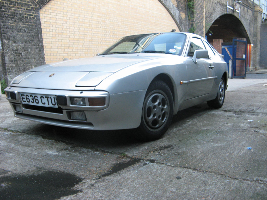

Here's a picture of it in happier times!
