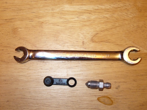

Same here, never broken a bleed nipple yet. It helps to have decent tools- get yourself am 11mm (also 7/16"- so works for brit classics too) brake spanner, this is a very thick ring spanner with a slot in it. This is where you need to spend on a decent tool. Also- heat the nipples with blow torch and spray with penetrating spray (plus gas etc).

Thanks for your positive suggestions. But.... I already have a decent brake spanner, shown below along side my new bleed nipple and I used plenty of PlusGas, and the short sharp tap technique but to no avail when I did it last. IIRC correctly this was also the day I changed my lower arms, so I think they rounded off and I just bled them from the other nipple, rather than struggle for ages Not ideal, but better than nothing. Plus two of the four that had rounded off were thanks to a previous owner, so you can't blame me for them [:D]. Heat I didn't try though, so that'll be next.

PS For seized bleed nipples I WD40'd, heated them with a propane torch and then used mole grips (I rounded off as well). Replaced with stainless steel bleed nipples (from https://sws1.eclipse.net.uk/www.h-e-l.co.uk/shopbleed.htm IIRC).
