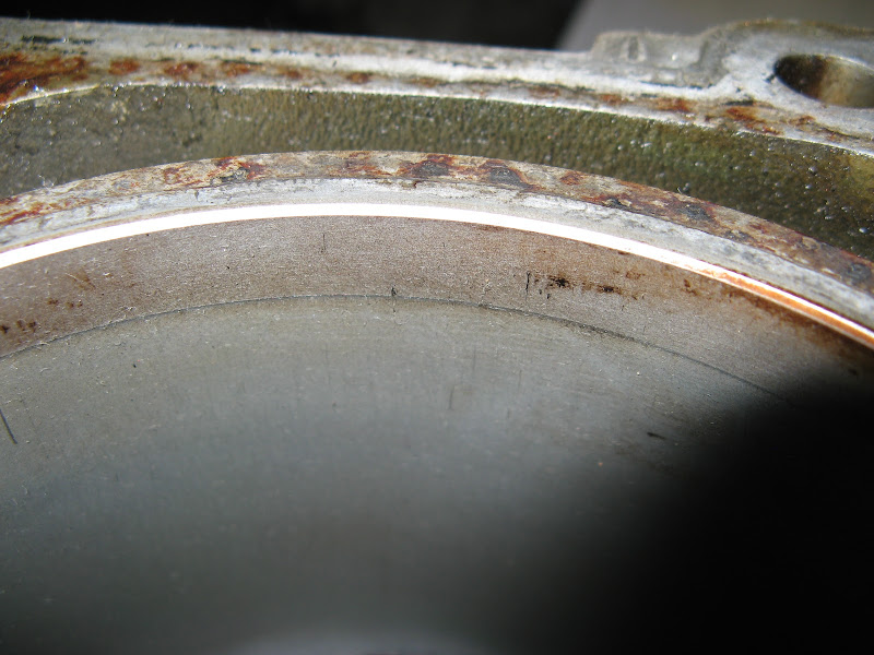

2. If you're going to all this hassle to rebuild the engine, is it worth going down the 104mm bore cylinder inserts as provided by either Hartech or Perfect bore in Hampshire ?

http://picasaweb.google.com/tombarker1804/944TBores?authkey=Gv1sRgCPKWzsCex4ak2AE&feat=directlink
Heres an example:
