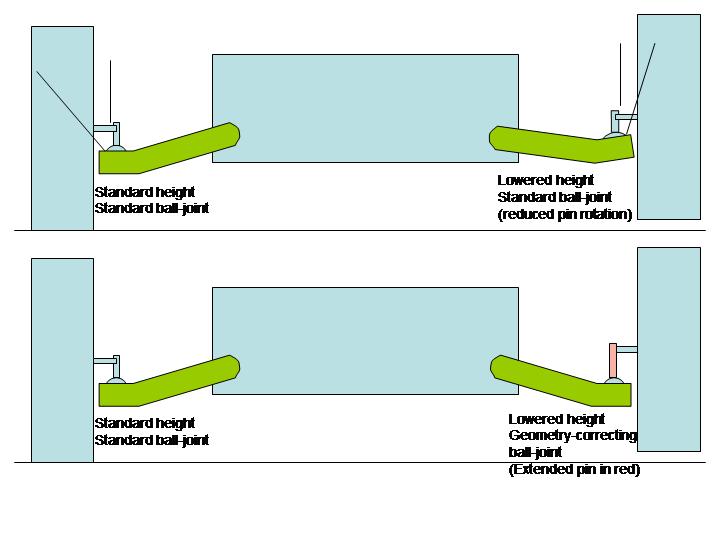

Hi EDH,
Its nothing to do with roll as in the sense of stiffness, it is to do with Roll Centre which is a geometrical calculation of the angle the suspension arm sits at in comparison to the suspension and where the weight is borne. Fitting longer pins will NOT make a car roll more or less. Its like stiffness does not always make for faster cornering If it did we would not bother with springs at all!
If you lower the car you really need to fit the longer pins or change your wishbones to Charleys, Racers Edge etc who make arms to correct the geometry when you lower the car. That is if you are intending to drive the car hard.
If you are just dropping it for aesthetics well thats a different matter but it still would be advisable.
