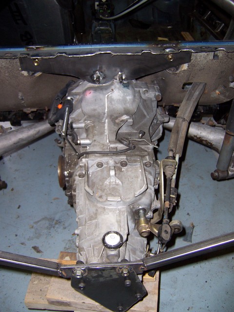

You definitely need to 'flip' the gearbox and possibly have a couple of other mods done to run one of these trannys in our cars. But it has been done before.
The n/a 996, Boxter, and I think Cayman engines are different to the GT3 and Turbos too.
Picture showing Boxter tranny transplant in a 944 with a V8 up front. Another advantage to doing one of these gearbox swaps is to be able to use much more substantial axles/cvs.
Interesting, what about oil, does it `bathe` the gears sufficiently upside down?
Paul, being in australia of course, its all upside down - so the oil will be in the top of the box.......that wont count......!
forgive me[8|]
I dont know the answer, but for sure it will be different

That's one of the other mods that has to be done to the tranny to run it in this configuration. There is a company in the US that specialises in this and other gearbox mods. California Motorsports. Very good to deal with. Ask for Roger.
