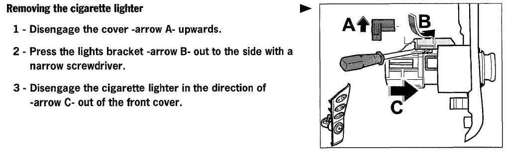

Thanks Richard, that's a pain. I'm in the process of trying the find the best way of putting the whole car on stands as I'm getting the wheels refirbed at the same time as well as replacing the starter motor, door mircro switches, backbox, front disks, rear wall, anti roll bars, cigarett lighter output, radio..........etc[:'(]
