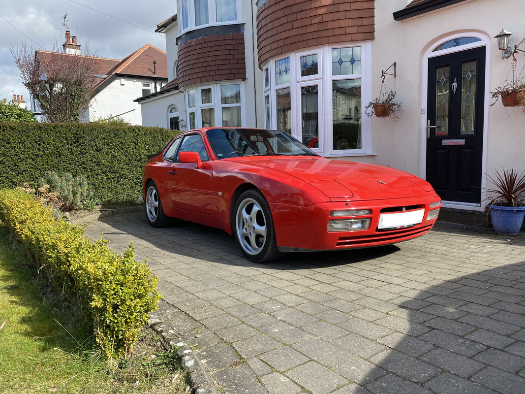

So after a beer too many I broke all the rules and bought an S2 online, blind, from a bloke I don't know.
It arrived Wednesday - no grief whatsoever!
So far the impending damage is one sill, which I new about, but the other is far from perfect. A set of brake discs is needed as well as putting some decent rubber on it. I had planned to find some D90s but quite like the wheels on it, so have corrected the rolling radius and width & will fit the 'right' size tyres on Saturday.
Initial impressions:
On the plus side, the paint almost matches on all panels, there's no smoke, the interior is damn near mint, barring a non restracting luggage cover and a little sun fading on the pin stripe section of the rear seats. Everything works and I'm remembering what my left leg is for after several years of DSG! It's pleasingly weighty and old school to drive.
In the 'To do' pile
Steering seems a bit vague around centre and some wheel alignment is needed. Nothing drastically off and there's no vibrations. I think a set of shocks may be needed as the front left feels soggy & its much happier in left handers than right.
Starts & runs nicely but is a little lumpy until its over 1500rpm, then pulls really well. Smells like it's a bit rich at idle?
Evidence that the belts and tensioners were done 2 years and 2000 miles ago - are there any common maladies here or am I staring at top end rebuild time?
Quite a bit of a whine from the transaxle once moving - from what I've read that's fairly common? No horrible clunks at least but certainly worth an oil change.
I'd budgeted to do at least one sill, replace the discs, pads, suspension and rebush everything so hopefully it won't run away with me.
(Yes I know the hanging baskets need sorting out)
Great looking car [8D]

Looking good, Steering / wheel bearing / worn damper probably all connected and shouldn't be anything too nasty cost wise - lots of suspension options!
Wheels are cup 2s if they are genuine they will have numbers stamped by the valve stems, if not maybe a bit heavier than the 'standard' (on other Porsche) items.
Not sure about the lumpy running but I think with an S2 you should leave it to tick over for a while when the battery has been disconnected / reconnected one of the long term S2 owners might remember! Other than that worth a check on engine earths / connectors and engine temp sensor.
Also with any S2 a check on cam chain tensioner / cams is important if no history of them being inspected.
Enjoy!
Tony
That does look nice [:)] Are you handy with the spanners and planning to do most of the work yourself? If not, whereabouts in the country are you and we could recommend some good independants and/or bodywork guys. I had an S2 for over 20 years (sadly gone [:(]) and personally put 140,000 miles on the clock and it used to get a rough idle when cold every 5-6 years which would mean cleaning the idle stabiliser valve under the inlet manifold. It can be tricky to get out unless you have pianist fingers but a reasonabe temporary fix can be achieved by squirting carb cleaner into the rubber hose that leads into it whilst idling.
With 17" wheels it's important to have the updated caster blocks from a 968. They have much less rubber and secure the back of the front wishbones to the chassis. I had 17" wheels for many years and loved their look but as I got older I had to admit their ride is nowhere near as nice as the standard 16" design 90's. As luck would have it I have a set of S2 sized D90's for sale at £300 that are freshly refurbed and never been back on the car before it died [&o]
Vague steering could just be poor alignment but it could well benefit from a new refurbed steering shaft from Waylander. When setup properly the steering is pin sharp. What sort of mileage is on the car? Congrats on the new toy and welcome to the forum [:D]

The car has 135k on the clock - there's evidence of the belts being done relatively recently, but I have noticed some oil staining around the cam cover gasket, so will have an opportunity to see what it all looks like in there fairly soon.
I restored and tuned a Hillman Imp about 20 years ago & still have a lot of the tools. I got pretty handy with a MiG welder (you had to with Imps), although it's a while since I stitched anything together. I'm happy to do the brakes, suspension etc myself. Fuel injection, ECU's and OBD are all greek to me as I was weaned on a diet of lusting after twin Weber DCOE40's.
Thanks for the pointer on the caster blocks - is that likely to affect the steering feel/alignment much? Am booked in for a set of fresh tyres and alignment check tomorrow. I have just noticed a slight flat spot in one of the wheel rims though so if there's an issue with that I may take you up on the D90s @Diver944.
First priority is getting brakes and tyres sorted out - am a bit lost in which bush kit I need to buy to sort all that out as well - there appears to be myriad sizes available for the same car.
