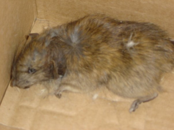

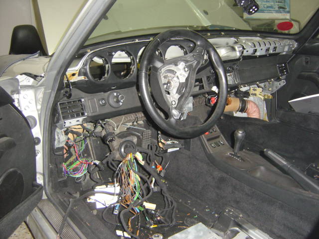

My 1997 993 2S has been mauled - no joke - by a Greek fruit rat!! The little bast**d has chewed its way through a good part of the wiring loom, the plastic panels under the bonnet, the sound proofing in the front and above the engine, the spark plug leads, the boots above the engine and so it goes on.
I'm on Crete and the closest Porsche garage is in Athens. I found an auto-electrician in Chania and low and behold he trained with Porsche in Athens and is also old enough to know the 993. How lucky was that?!
The engine and gear box is out, all the interior is out and the dials have been out but are now repaired and back insitu. I'm now waiting on parts to come from Germany.

ps they found the rat - dead - at the back of the engine!!
Pic

What has impressed me re the whole sorry tale is just how solid and well built these cars are. Everything has been stripped out and if you want to see the full disaster then follow the URL below to my day by day picture board of the damage and the car stripping process.
The car is solid through and through with no sign - at all - of any rust. It's amazing considering it's 13 years old.

Porsche in Athens have come back to the auto-electrician here on Crete and the price for all the chewed plastic parts and associated hoses etc. is around €3800 or £3500. It just goes to show that cheap plastic parts are not so cheap when sold by Porsche!!
There will of course be the labour charges over and above this - can't wait to hear that number!!!!

The loom was chewed in various places - see pics but because he's an auto-electrician by trade he said it would be "easier" to repair rather than replace the whole loom. I was worried it would compromise the look if anyone removed the carpets etc. but the repairs so far are excellent. The mechanic said they'd recently replaced a Merc loom and it was €1500 from Mercedes. They've checked the whole loom i.e. through the front wings, into the car, out the back etc. and luckily the rat doesn't appear to have got into the cabin itself, although you've got to wonder how it got from the front to the back of the car. It drove to the garage so although wires and sound deadening foam was chewed in the engine bay the worst damage was at the front i.e. plastic boxes, pipes, hoses chewed as well as the wiring loom. The only reason I noticed was the dials didn't work and when I turned on the aircon the chewed sound deadening foam blew into the cabin.
Bad news though and yes, I've already got some Greek made anti rodent spray - especially manufactured for cars.
