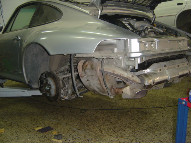

The engine is now back in the car and most of the parts below are also in place. I never knew how the exhaust and silencers fitted beneath the car - it's quite a neat engineering trick
Jon
When you think about it all the rat actually did was chew a bunch of plastic parts and some wiring. All the chewed plastic parts have been replaced by brand new Porsche parts i.e. almost 3800 euros worth and the wiring loom has been repaired. The garage owner told me before taking on the job that when finished you would never know the loom had been taken apart i.e. the exact same rubber sheaf Porsche use would cover all the repaired wiring. I must admit he's been as good as his word.
The removal of the engine and gearbox was a little scary - at least for me - but because the sound proofing at the back of the engine bay was badly chewed it was the only way they could replace it. And once the engine was removed it became obvious there were several hoses coming through the back wings into the rear of the engine which had also been chewed -see the attached pic showing the hoses and also where the sealant has been replaced and repainted. All these hoses have been replaced with new. What's more, because the engine was out and drained of oil all the filters etc. had to be changed - which is something of a bonus. Interestingly, they told me tonight that the filters and plugs they removed - whilst perfectly all right - were not Porsche parts. They've now been replaced with genuine Porsche parts.

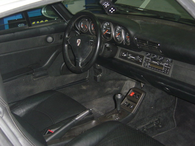

The engine looks better than before - see the pic below - and I'll post a pic of the "returned to its pristine best" interior in the next post. If you look further up this thread you'll see what it looked like 7 weeks ago.

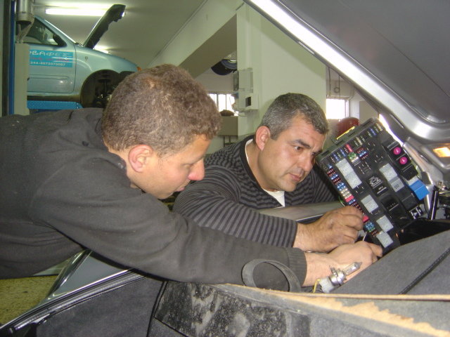

You might as well see a pic of the guy who returned my baby to her pristine best - Adonis is on the right looking at the fuse box.
