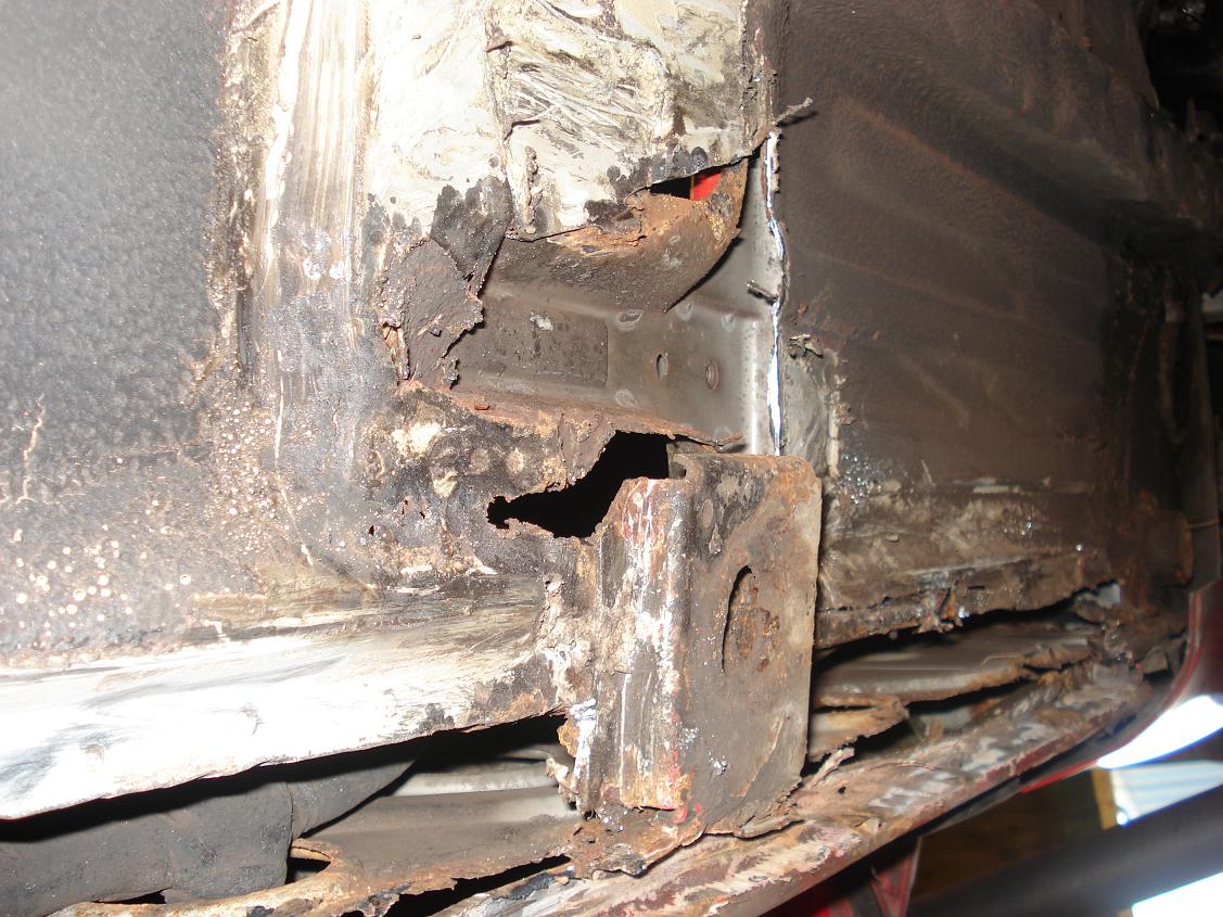

lee noble brought a 944 turbo and a 944 tubro S, the S had a rotton body so was striped and parts used on the turbo which was upgraded into a S with lots of new bits used. The turbo and intercooler are brand new not second hand.
£5000 was spent on the refurb but does not include bits from the turbo S that were used

This car came up before, IIRC. It looks good value if it's been properly welded and sprayed - I'd guess they'd have all the receipts and probably pictures of the work?

If the interior is truly mint (side of passenger bolster looks floppy) and the bodywork repairs have been done well then this could be a very sound buy with all the expensive work recently attended to (clutch, sills, brakes and suspension are all expensive)
