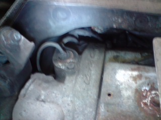

Hi Richard....removed the air box again last night and played around with all the electrical connectors i could find in the rear engine space, ie just disconnected and then reconnected them. Followed each electrical line as far as i could and did not discover any loose wires or worn insulation anywhere.

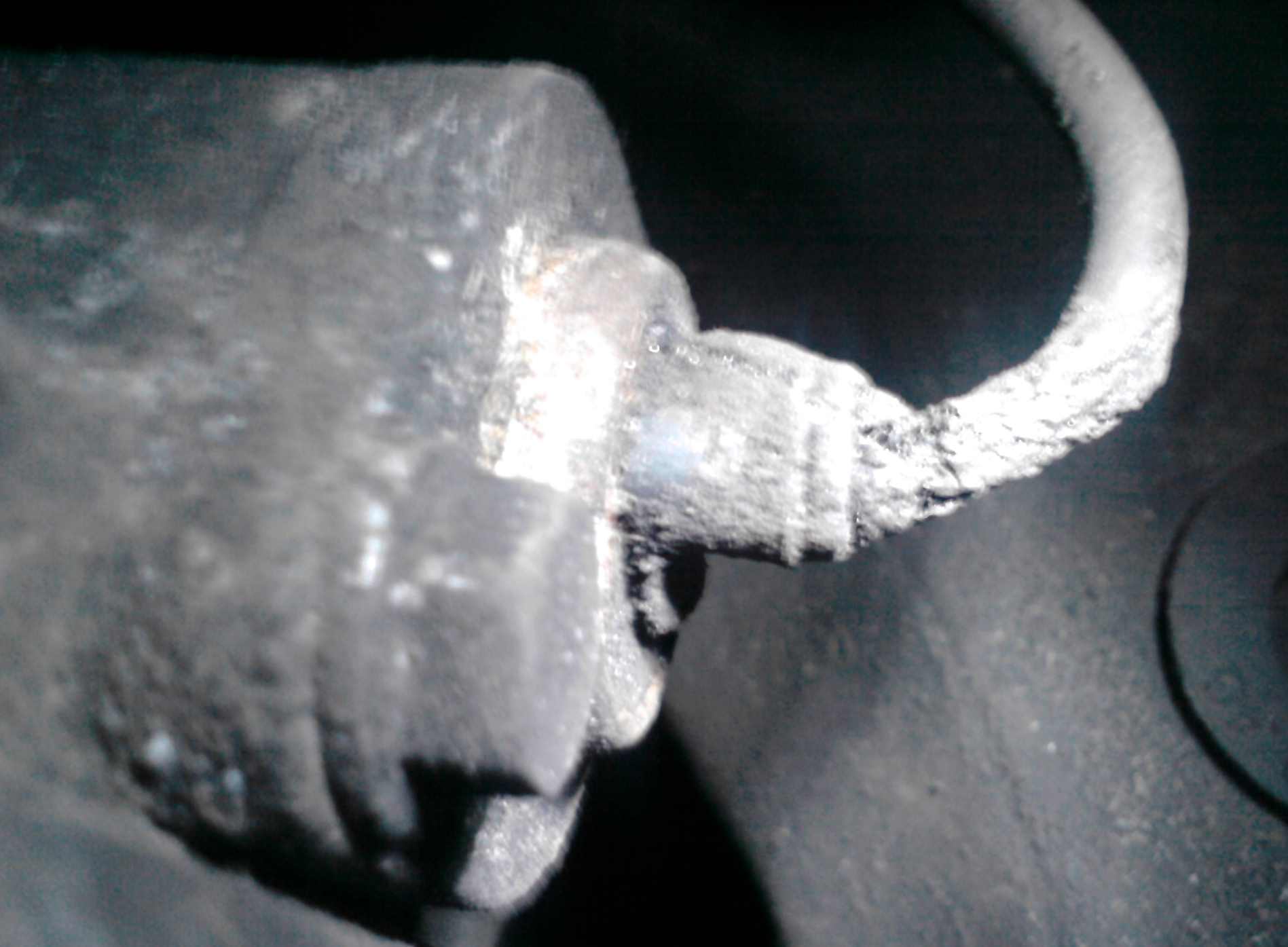

Anyway, once i had refitted everything i decided to jack the rear of the car up (passengers side). I've now discovered where my vario-cam is. The unit seems to have a braided wire running to a fitting which seems to be held on with 2 bolts. The outside coating seemed a little brittle and slightly crumbled away leaving what i think is about half the braiding at the connecting point. I followed this wire which then seems to go into another fitting on the engine,(maybe the variocam solenoid, or is the photo itself the variocam solenoid??). Not sure how this connects or disconnects etc but seems very solid.
A long shot i know but do you think that this slightly corroded wire could have caused the problem and if so do you know how the other end etc can be disconnected and replaced.

That doesn't look like the Variocam solenoid, but it does look suspect, whatever it is.

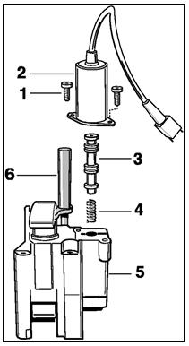

The v/c solenoid has a coil which is screwed to the cam cover, and has a plug as shown in the attachment.
Edit: After reading your post again, the lumpy idle sounds very much like a variocam solenoid. If the wires are intact, perhaps the coil has shorted out inside.

Sorry, once again as i typed my last message thought what the hell and got under the car again. Took another photo Richard. The fiitting photographed earlier may have been too close for you to see. I have taken a shot further out. Here you can see this fitting fastened to the side of the variocam unit. This is why i thought it maybe the variocam solenoid. Looks a little like your picture, if you look closely you can see the words variocam. Do you think i am ok removing the bolts and replacing as the wire is not that brilliant. Could this be the issue??
The photo was taken lying under the car just behind the wheel facing inwards and up.
Edited: I think that is the Variocam solenoid. Something is shorting out, which is blowing the fuse, but I can't say it is the solenoid for sure - it is just that someone else had it happen. If you trace the wire back, you should find a connector a few inches back. Try disconnecting it to see if it stops blowing a fuse. Remember there is one on the other bank too!

richard....disconnected the plug as stated and car started and continued to run. So it looks like this is the problem after all. however, once i had removed the 2 bolts the unit didnt want to come out. is it just stuck or do i have to unscrew the unit itself?
